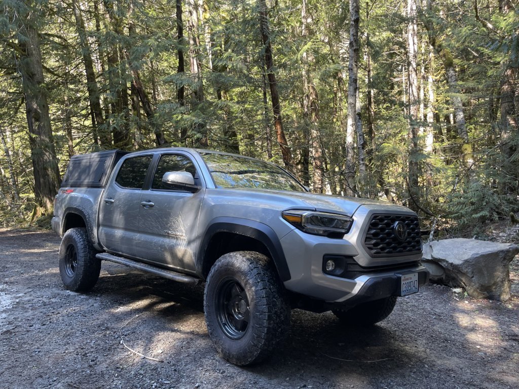

    2022 Tacoma TRD OR; 2002 4Runner
    I did not. It doesn’t really bother me.
    But… there are plenty of variables to consider.
    • How many hills / mountains in your life?
    • Tire AND wheel selection
    • Do you see yourself as race car?
    I have full steel skids and sliders as well as a canopy. But, I also selected one of the lightest wheel / tire combinations available. Unsprung rotational weight will have a big impact on overall performance and your perception of sizing up.
    start looking at wheel weights and tire weights and you’ll soon see a huge difference in some of the options that are out there. IMG_3508.jpg
