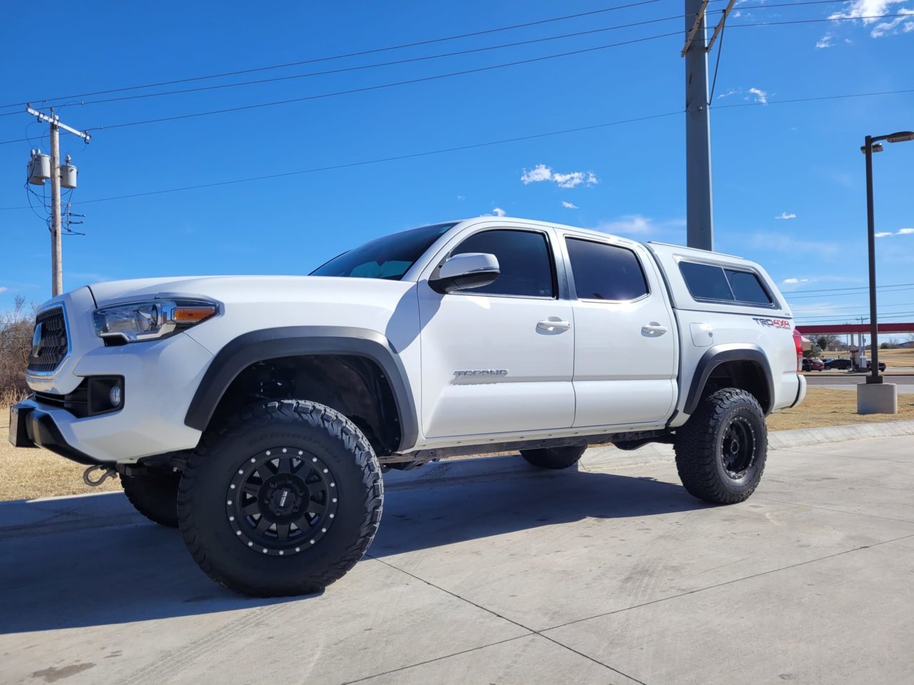

    My question is whether the Bilstein 5100 will support the Icon leaf spring if installed as "Option 3" with the rear 2.65" lift?

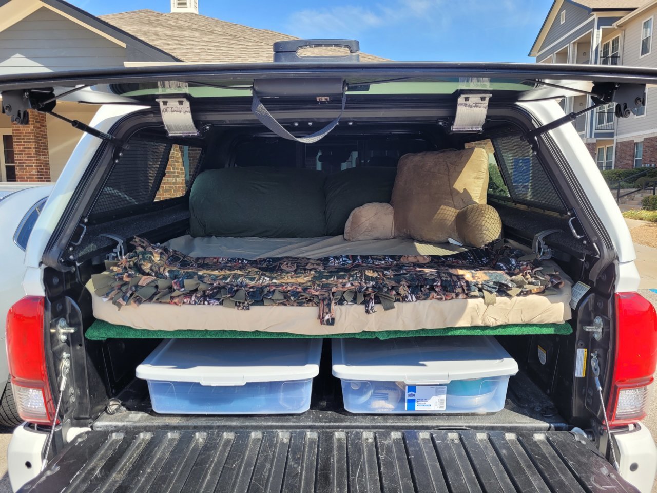

    I added a shell and bed setup to my bed and got too much sag in the back. I am currently running:
    1) Readylift 3" Front / 2" Rear Lift Kit (Rear on blocks)
    2) Bilstein 5100 Rear Shocks
    My end goal is to have the truck near level at 3" with the camper shell and bed setup. I have decided to upgrade the rear leafs to:
