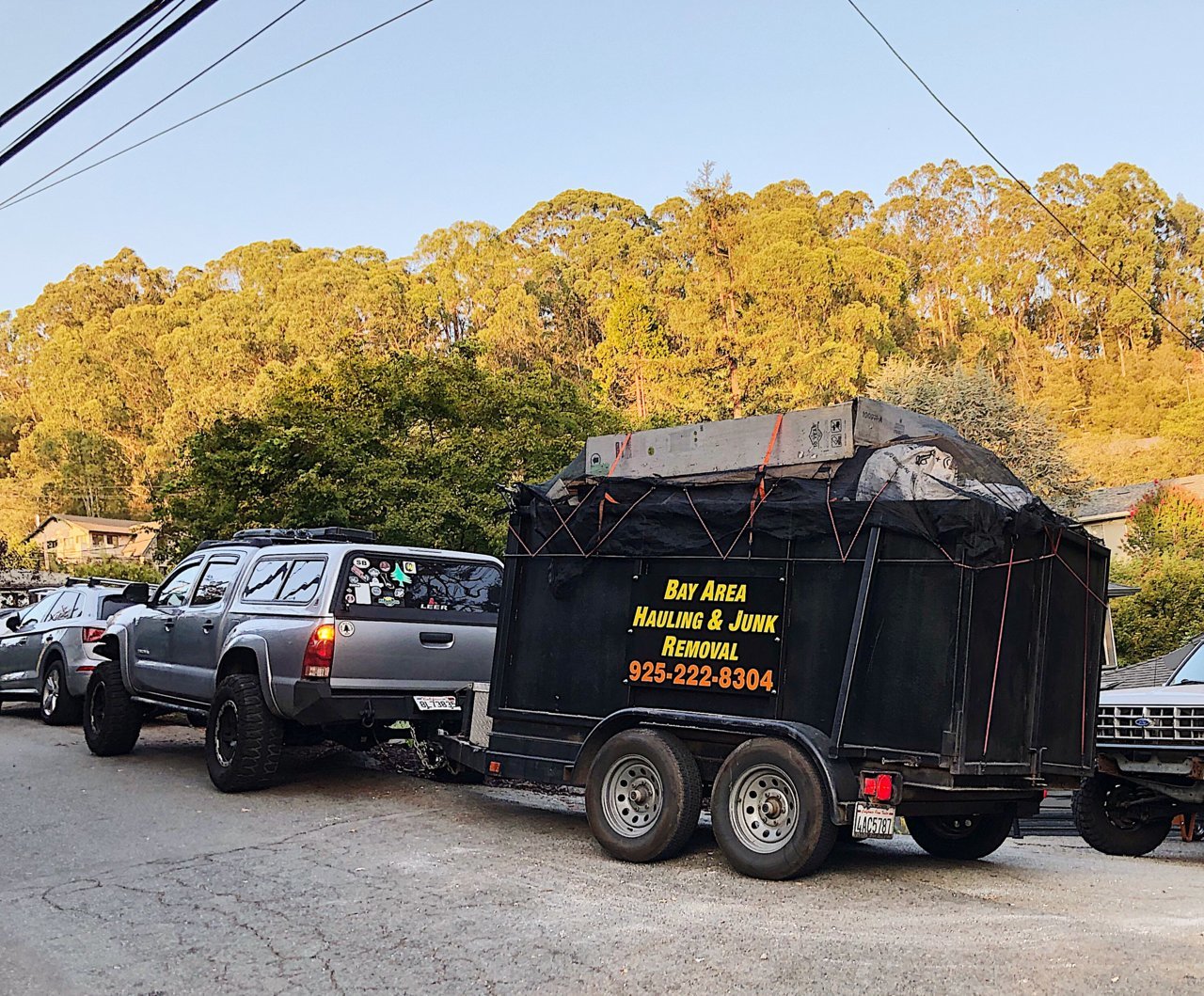

    You should be fine. But just fyi these trucks aren’t great at towing for the long term.
    Here’s 5k+
    Was OK pulling it on flat ground. It was horrible going over any type of incline. Declines are fine with trailer brakes.
