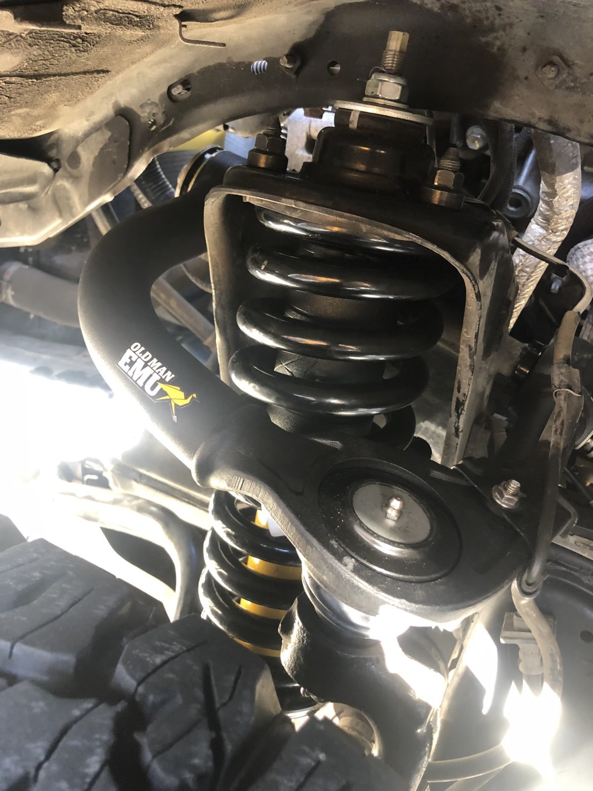

    I went w the OME UCA’s, The 2.5” lift from Mudify has been great! Just running 265/75-16’s on my stock OR wheels and it handles awesome off road and hwy.
    Driveway install was pretty hard tho, Had a good buddy help me out. Took us a full day, UCA’s are not user friendly to take off stock ones, What a pain w the huge long bolt to remove and no room to get it out!!
