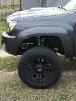

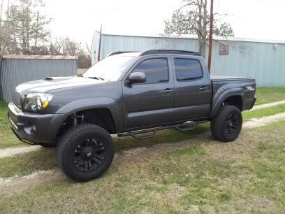

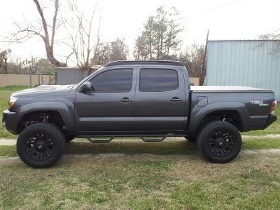

    Here is my spindle setup. I just finished over the weekend. I have my CO's set around .75" for around 4.75" of front lift. I really couldn't go higher unless I wanted the bro lean.

    Damn good lookin setup bud.
