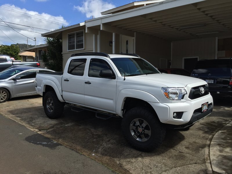

    No wheel spacers 285/75/16 , 2015 TRD Off-Road, 3inch lift with 5100's ome 887 coils , LR uca, rear lift - toytec boss progressive aal with overload and toytec 3 degree aluminum shim total 2.25 lift. Removed front mud flaps after that no rubbing at all during street driving and off road on beach sand to fishing spots and really uneven dirt road

    Did you color match the front grill and rear bumper? - Looks great.

    Lol no I used plasti dip white along with the plasti dip glossifier

    Thats what i was referring to when i said color match. I plan on doing the same to the rear bumper, but probably order the replacement oem super white grille.
