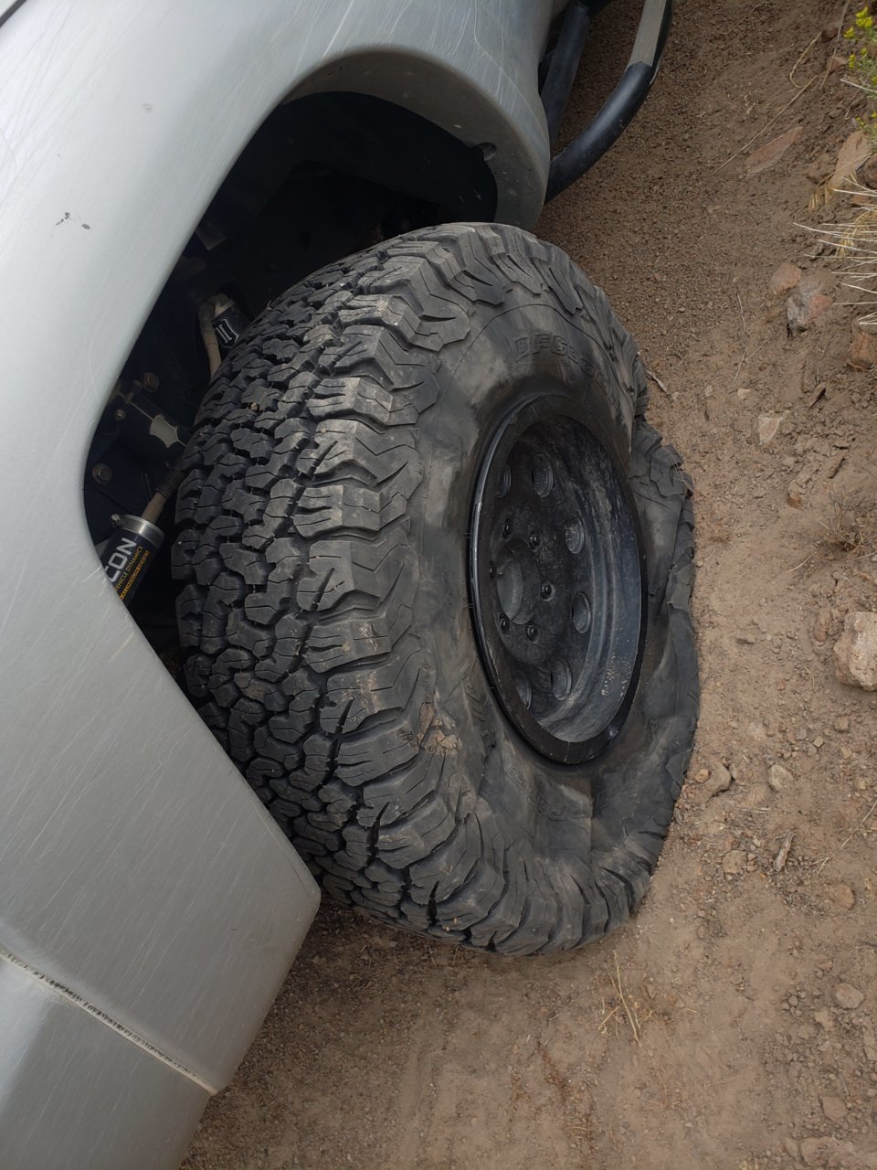

    I managed to puncture 4 E-load KO2s in 2021 alone. I would not consider switching to C-load tires for my vehicle. But either way I'd buy them at Discount/America's Tire -- they keep replacing them for me, even though I tell them I am using them (poorly, evidently) off road.
    I did finally install some spotter cameras in my truck, no more PFFFFSFSSSSSSSSSSSsssss since.... Fingers crossed for 2022!
    For what it's worth, I don't think you'll see your gas mileage bounce back substantially going from E to C. Some, yes. But if you are running big offroad-style tires with 700 pounds of crap in the bed, you aren't going to get stock mileage.
