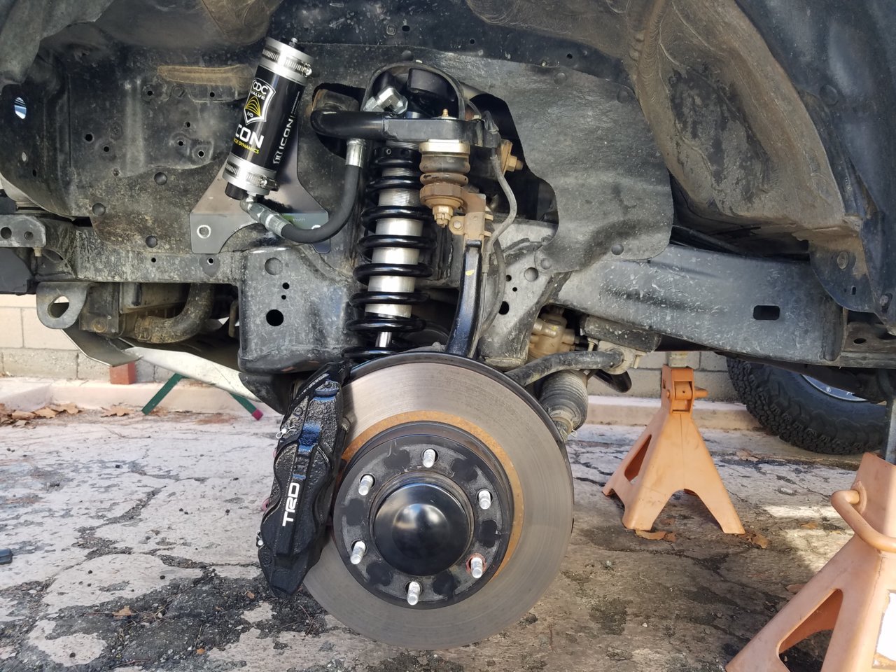

    Since your post is pretty vague I'll give the reasons I put reservoir front and rear on my Tacoma.
    I'm consider myself a 'go fasty'. I like embarrassing dirt bikes and UTVs in the desert by keeping up with the A/C on. I can't keep up fast dirt bikes and UTV's but most I can.
    Originally I had ICON 2.5 C/O in front and 2.0s in the rear w/o res. Most of the time this worked well. But on fast dirt roads and a heavy camp load the rear would get pretty mushy and pogo about.
    I noticed that if the rear shocks were too hot to grasp for more than 2 seconds there was noticeable shock fade. I installed a set of ICON 2.5 with compression adjustment in the rear and they stay fade free all day. Plus the comp adjusters worked well when the bed was heavily loaded. The front C/O's were just warm to the touch with out any fade.
    Later I installed a winch and bumper with rock sliders. After a good romp in sand woops the front gets hot to the touch and the bump stops were getting a good work out. So I'm just finishing up putting CDCV reservoirs in front with 700 lbs springs. Have not done any test drives yet so I can not comment on the results but they do add 'coolness'.
    IMO evaluate the 'need'. Does your driving style cause the shocks to get really hot and fade? Do you want to compensate for light or heavy loads? If you answer no than you probably do not need reservoirs.
    If money is no object then reservoirs become a 'want' and do look pretty cool.
