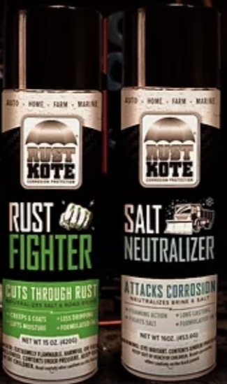

    I’d spray down the front boxed sections and the rear leaf spring hangers with salt killer and rinse then spray on this shitB953CF95-CD4A-412A-ABB4-A8FCDABF0359.jpg do the floor under your seat, too
