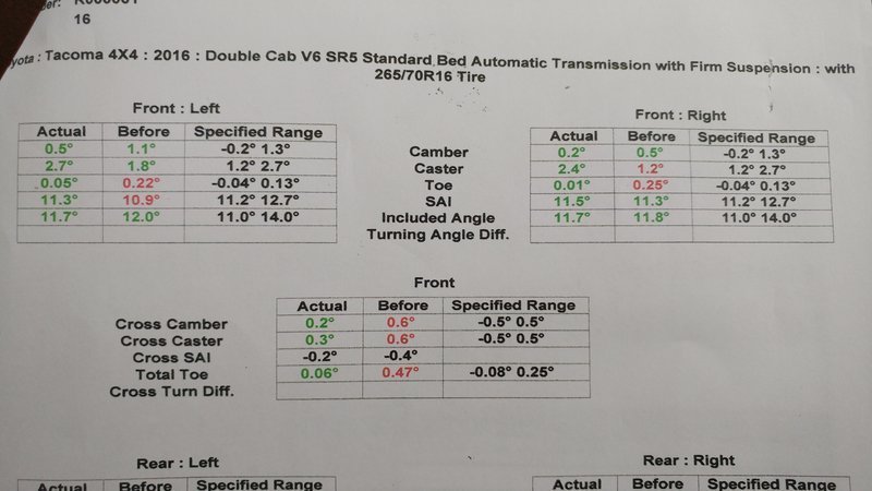

    Not to hijack the thread, but I'm kind of in the same boat...
    So a couple months ago, I put on the Bilstein 6112 w/ springs & 5160's in the rear. I set the height to the 3rd notch, and got approximately 1.5" - 1.6" of lift in the front. I am looking at getting some new tires & wheels in the next month or so, and was wondering if I should upgrade my UCA's as well? As I don't have much experience with Tacomas, I wasn't sureif this is needed. I get that yes, technically it is needed, if you want to be back within factoryspecs for alignment purposes, but with only a 1.5" lift, is it practical to spend $650 on UCA's for this setup? Only looking at going tothe 17" Sema Wheels and 265/70/17 tires, so nothing to crazy.
    Was looking at going with the Total Chaos UCA's, if I did decide to get upgraded parts. But if I don't really need them, I could spend the money elsewhere...
    Here's my specs after my alignment, any thoughts or opinions are greatly appreciated.
  11. Nov 7, 2016 at 10:50 PM

    If you're under 2.5" of lift and can't get a decent alignment, go to a new shop. UCAs won't fix low quality work.

    At 1.6" lift you definitely do not need to cough up $600 for UCAs. That money is best spent elsewhere.

    UCAs aren't so much for rubbing issues as they are for alignment issues that become more of a concern the higher you lift your truck. General consensus is if you're under 3" you're okay with stock uppers. I went with the SPC light racing UCAs ultimately because the boots were shot on my stock upper ball joints and figured I may as well upgrade (there was a killer GB going on last month for them too). They're priced reasonably well though especially compared to some of the uniball UCAs out there. They're greasable as well, the stock ones (at least on the first gens) aren't
