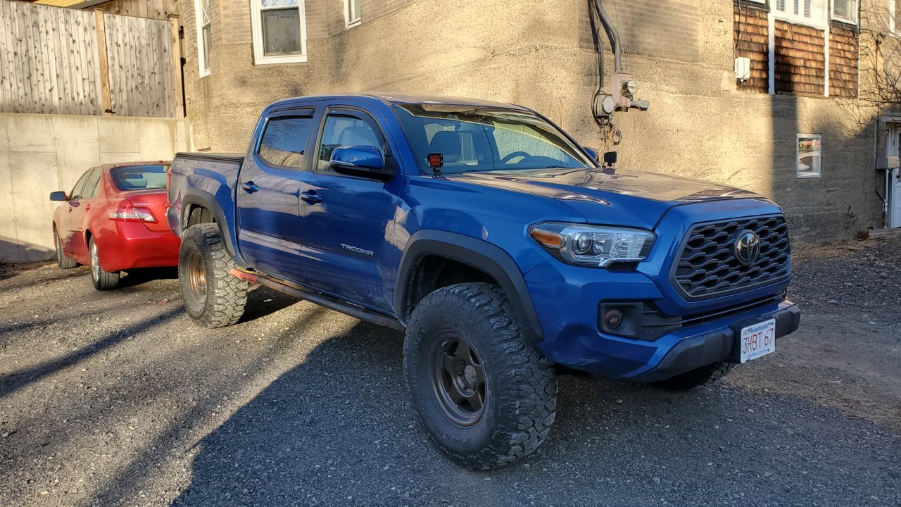

    I have that exact package and I'm rubbing uca at full lock (I have factory uppers still), I'm going spc's to get the tire off the spindle but be prepared for that. On the plus side the wheels look sick :cool:

    Damn that looks super good. What suspension you running?

    Bilstein 6112/5160s, I'm at notch 4/5 I think? But yeah I have a cmc I may or may not have to redo, we'll see when I get the spc's on and the lowers cracked forward, pinchweld fully flat smashed outboard, fender lines removed and intake rerouted to the cowl, it's been a process but im so stoked on it.
