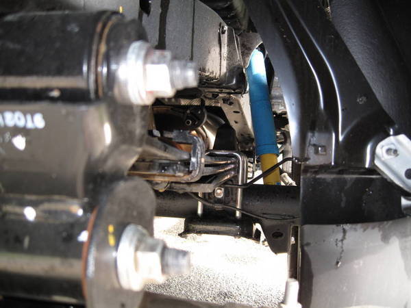

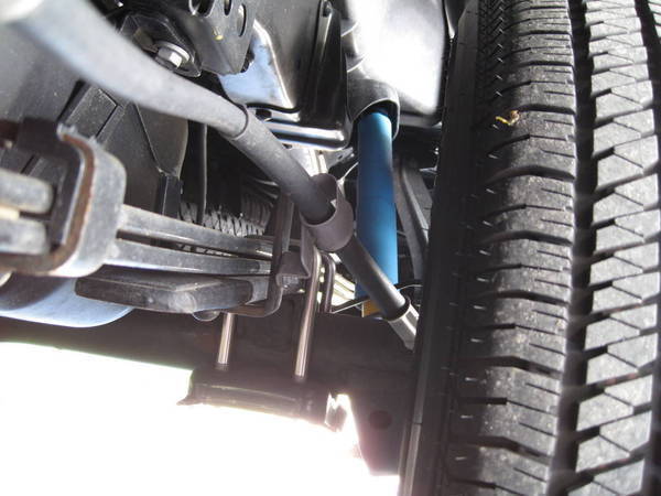

    Goin' to my Dealership for my car's oil change, Thursday and thought I might bring these picture & the TSB. I've been reading about (and downloaded) the Leaf Spring TSB. This Tacoma has a 175lb Leer Cap and a 25lb +/- Bed Mat as the only weight on it. And has had nothing more than a 25lb tool bag behind the passengers seat, and 175lb. Me. Now I'm no mechanic, but from my experience, I always thought the lowest point on a a Leaf Spring was at the Axel.
    So, the question is; Should my leaf springs look like this with only 200 pounds on the truck. Also, there's 2 Pics of the "Bump Stops" (if thats the correct term) that show evidence of impact. I have never felt it bottom out, and it seems to ride and take bumps OK. It's only got 1730 miles on it.
    I also expect to be doing the Transmission TSB, as I have the symptoms.
    I have a couple other questions, I'll post in new threads, but I'll include them here, and maybe get the answers.
    Slight "Shudder" during acceleration from dead stop. Anyone else?
    I find myself CONSTANTLY correcting my steering at highway speeds of 65mph or faster. Tends to want to drift left or right as soon as I've corrected the last drift. Maybe it's just 4 wheel drive, as this is my 1st, or just inherent in the Tacoma, but I can't imagine it would be, and I haven't seen any posts on the issue.
    Once again I'll post these elsewhere. The Leaf Springs are my primary issue a present.
    Thanks for your help in advance
    Brought My Solara for Oil Chg, 05/13. Brought above Pics of Tacoma Springs.
    Service Rep: "Have heard of Leaf Spring TSB, Springs Look Normal". "Bring in Tacoma Tues, 05/18. Will have Technician Drive It, and Evaluate Springs, Transmission Hesitation, Shudder, and Drift.
    05/18: Tech: "My Own Bump Stops have Marks. Pics of Springs look normal, but You'll have to Talk to Service Manager about the Springs.
    Tranny Hesitation: "Exists". Tranny TSB Reflash done 1/2 hour later.
    Shudder During Acceleration from Start: "Noticed Minor Shudder, but NOT abnormal". (I could feel it every time he accelerated).
    Drifting left/right: "Unable to duplicate" (I'll deal with later)
    NOW THE SPRINGS............
    Sat down in the Service Mgr's Office. Showed Pics and Brought Up TSB.
    He Explained "the Springs have a lot of movement, for the ride. The Bump Stops get Impacted. That's Normal".
    I Explained, there'd not been more than 200lb in the truck (Cap & Bed Mat).
    Serv Mgr: "Bump Stops will still hit. I have an '09 DC, so I'm familiar with the truck and that's normal, do You have the DC"? No I have the Access Cab.
    Brought Up the TSB again. He didn't want my copy, He looked it up on his PC, and started reading,......and reading. "Doesn't apply to Your Truck, Bump Stops and Shocks were Upgraded at Factory" I Explained Springs Only and an alignment for my Truck.
    Serv Mgr: "Look on pg 3, Only for '05-'08 TRD pkg". At which point I suggested looking farther down where it said, 2009-2010 Non-TRD & TRD pkg.
    He read on. At this time I explained I am an electrician, and the truck was bought for my business. I carry tool and materials all the time.
    Serv Mgr: "Oh, Electricians are harder on trucks than anyone, they're always overloaded". At which point he got up , walked out, and went to his parts dept. When he returned...............
    Serv Mgr: " I have no problem putting new Springs on Your Truck. Keep in mine you'll get a harder ride if you have an empty bed. And I didn't know they had new springs for MINE! I work my truck. What do they do? Replace the 3 Leafs with 4 Leafs? Can I take yours for a ride"?
    So off we went. He couldn't duplicate the Drift or Shudder, either, but said it drove just like his '09 DC. But he did notice that the Cap, pre-loaded the springs and gave my truck a different ride than his. When we got back, he told the Serv Rep to Order My New Springs. (Scheduled for Wed. 05/26), then turned to me and said:
    "Here's my card, will you call me and let me know how you like the new Springs".
    Who da thunk?

    That's the three-leaf pack alright. You are eligible for the leaf spring TSB. If you are bottoming out (as it looks like you are from the bump stop impact pictures), take the truck to the dealer and show them, and tell them you heard it's a common problem and there is another 4 leaf pack that can be installed.

    Go describe your symptoms to the dealership. You don't have enough load in the truck to make even the weaker of the 3-leaf packs compress to the bump stops in normal driving. That tells me the TSB is probably not the first thing to look at.

    I'm trying to find out if the curve to the springs looks or is normal for a 200 lb load

    They look bent backwards to me, so my answer is no, its not normal. They should have a "U" shaped continuous curve.

    springs definately look like pooh pooh. go and get your TSB done.

    I thought one of the points of the TSB is that the stock springs allow the truck to bottom out. Hence the marks on the bump stops.

    Yes, but that shouldn't happen with only a 200lb load... those look awful. My pre-TSB springs took about 400lbs and a bounce to bottom out. You have all the right symptoms to get the TSB done. When I took mine in I even rolled under the truck and showed the tech the marks on my frame. He drove with me (I had sand in the bed) because he had to but was already convinced after seeing the marks.

    Yah, they do look Ugly, but I've had nothing to compare them to. And I have no idea if they were some "new technology" spring. LOL. Anyway, I haven't been aware of it bottoming, and the ride doesn't seem bad. The TSB requires them to do some measurements, but I'll be damned if they're gonna remove my new cap. I'm hoping they'll look at the Pics and the TSB I'll bring with me, and say "When do You want to schedule it?"

    Your bed shouldnt sit that low with 200# on it. You should get the TSB done.
