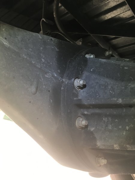

    I checked mine today and all were right around 10 ft lbs and I got them all to 18 and plan on leaving it alone until I find time to get it into the dealer.
    My VIN is on the list and mine is leaking. I'm thinking I'm going wait till I get the recall letter in the mail and give the dealer time to know what they're doing when these come come in.

    Yes. Appears to be leaking quite a bit. I'm going to hold off on taking it in until I get the recall letter in the mail and hope the dealers have a game plan by then.

    Smart move waiting, dealers not so smart sometimes. I would just make sure to keep on eye on it, it doesn't look critical (soaked/wet) so it should ok till then.
    But if they do take down the 3rd member for gasket and new studs, I'd make sure or insist they change the axle seals, I can't make out if they're going to replace them, it sounds like it, but not that clear to me at least.
    Good luck!

    Mine looks the same as many others, weeping oil stains.

    Pop's 2016 TRD OR has 40k miles on it. He changed rear diff oil at under 10k to remove the break in oil.
    Stopped by the other day and looked underneath, sure enough there was some weepage of oil around the 3rd member gasket. His vin was NOT included in the recall.
    I told him to go by the dealer and get it documented that its weeping a little (no drips but you could see oil spread on the surface) then when the recall does come or he does have problems its been documented.

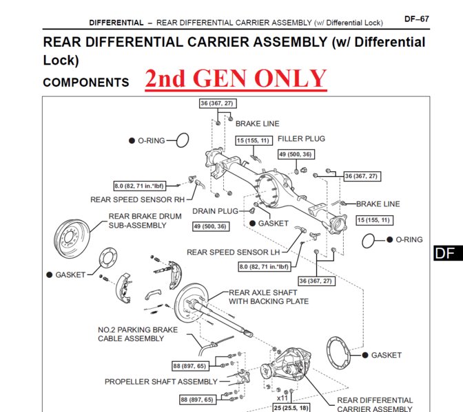

    For what it's worth, the recall does not replace the studs or nuts if there is no leak, just tighten to 18 ft-lbs, and call it a day. If there is a leak, further instructions will be coming.
    Also, the repair manual states 18 ft-lbs for all 8.0" (BD20D with M8 studs/nuts) differentials and 33 ft-lbs for all 8.8" (BD22A/BD22AN with M10 studs/nuts) differentials (with or without locker). I'm not sure exactly where the information came from that some BD22's used the smaller studs/lower torque value except maybe from the torque value listing in the repair manual that lists all 3 in order but doesn't differentiate (haha) which is which. Generally speaking, I find the lists to be much less useful than looking up the specific components and finding the torque values listed there.
    It would seem to me that the recall is only for automatic trucks without differential lock, based on the torque value that the recall instructions give.
    Actually on 2005-2015, models without diff lock had 33 ft-lbs, models with diff lock used 18 ft-lbs.
    The studs are not pressed in, they are double-threaded studs. They can easily be removed from the housing.

    Wrong. (FYI THIS IS FOR A 2005-2015 REAR DIFF WITH LOCKER.... NOT A 3RD GEN)
    FYI. I did notice the stud size on my 2nd gen was smaller (m8 w/ 12mm nuts) vs the stud size on my dads 3rd gen TRD OR auto (m10 w/ 14mm nuts).
    Should the large stud / nuts be torqued to 33ftlbs or 18ftlbs? Also where the hell are people getting the 33ftlb spec?

    My mistake, typo. For 2005-2015, without diff lock is 33 ft-lb, with diff lock is 18 ft-lb. For 2016-2017 A/T without diff lock is 18 ft-lb, M/T and A/T with diff lock is 33 ft-lb.
    33 ft-lb. As for where, I am looking it up in the repair manuals. I checked 2005, 2015, 2016 and 2017 repair manuals on TIS.
