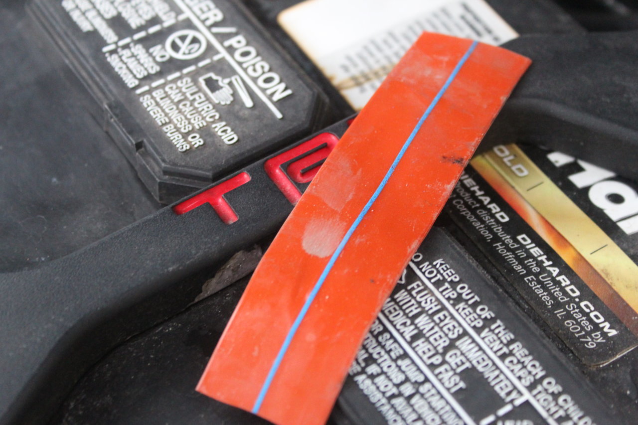

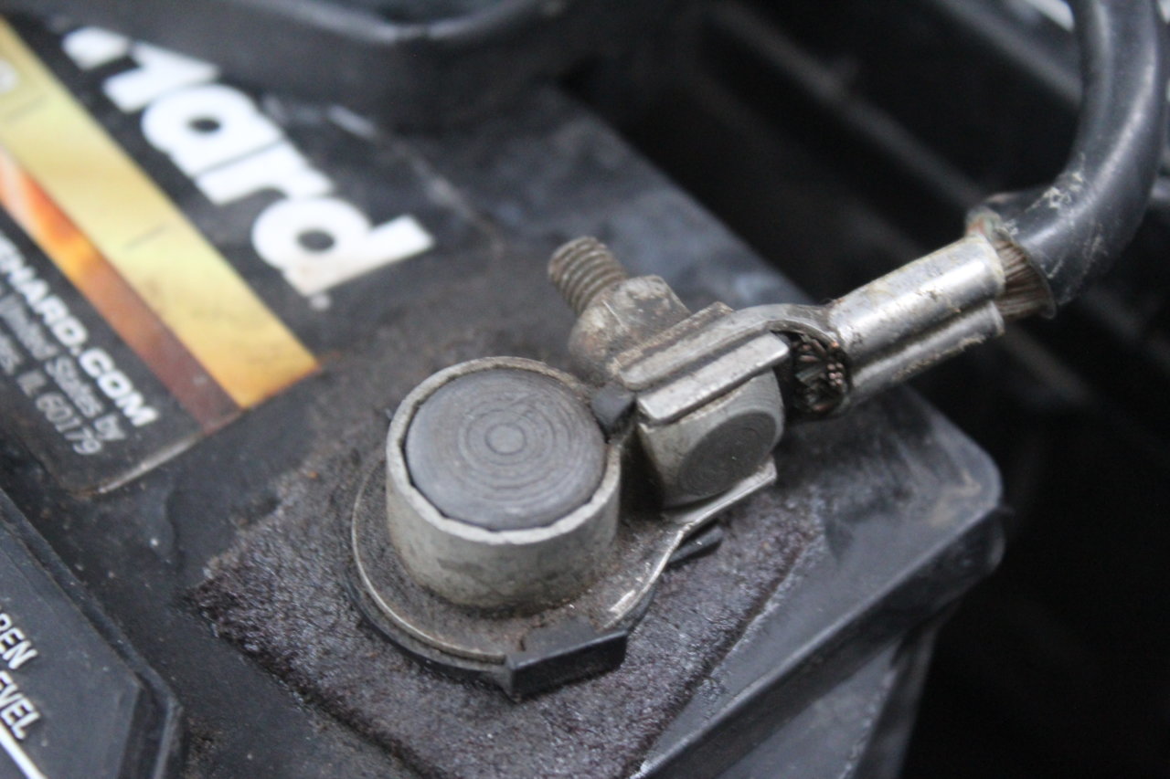

    @CS_AR :notsure: i tried to re-wrap the battery terminal, was pulling the tape hard stretch and overlapping it, but then i checked it in a few hours and it all came undone
    does humidity not work well on this, it was rather rancid here today, about 79% RH
    si idk why it did not stick
    the black electrical that was onit for so long just decided to start unraveling recently

    Looks like it wasn't stretched out enough. Stretch it out like the guy in this video.

    Almost looks like you left the plastic protective coating on it that you need to peel off.

    is there double protective coating? one on each side?
    i took one side off for sure, if there are 2 sides i FAILED again

    I think there are, at least on other brands I have used there were.

    well i honestly could NOT find any double coating to peel on that orange F4 stuff

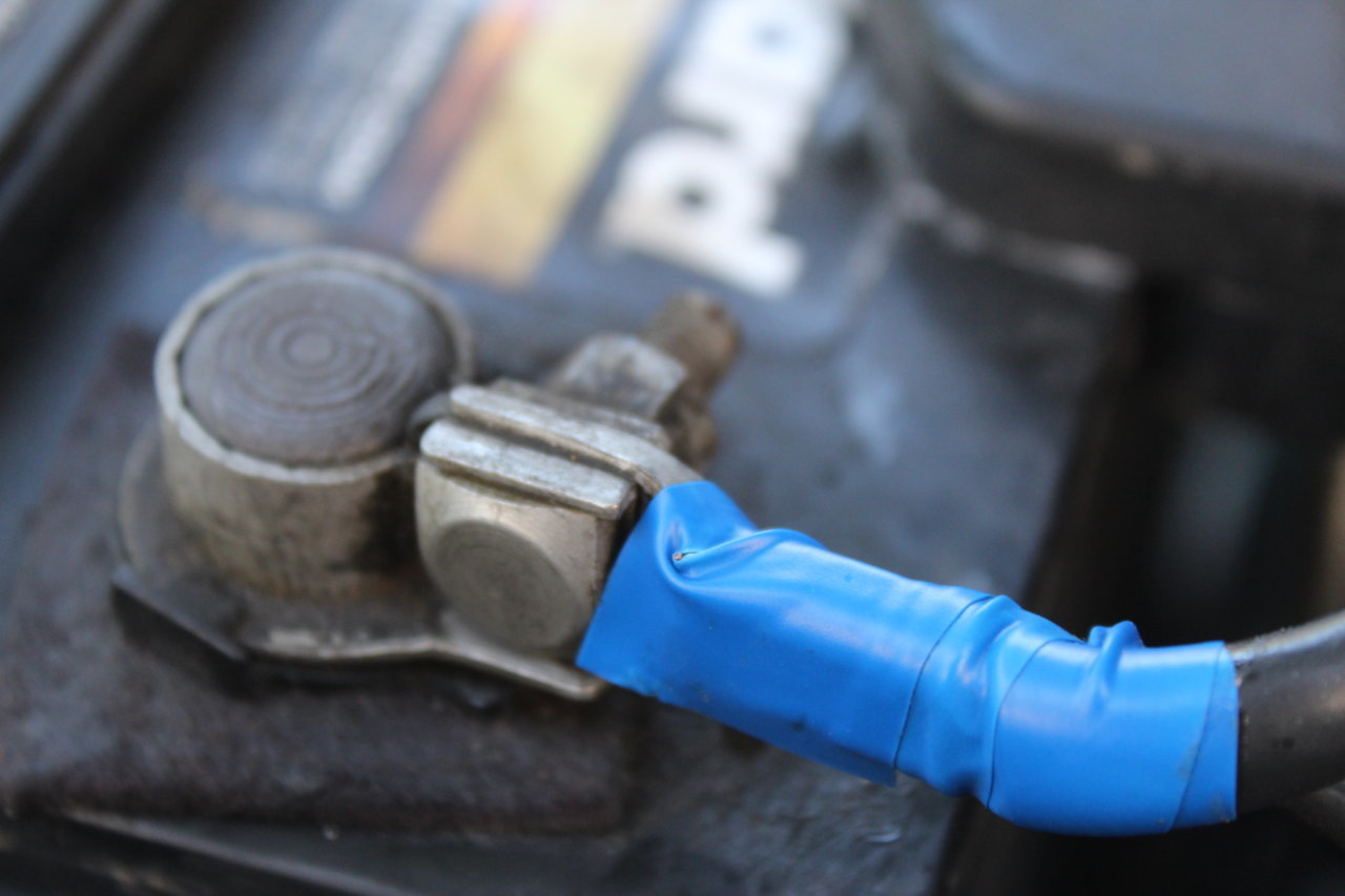

    had to resort to some swag blue electrical from china, its not even 3M grade lol

    will there be bad issues popping up with this swag blue china made electrical tape?
    i put a serious amount of time and effort into that work right there

    looked at it again and saw i put it on upside down with the blue line up so that is how it did not stick?

    Doesn't matter about the blue line being in or out. Just need to stretch the tape out and then wrap it. I usually cut strips that are 8 to 10 inches. Peel off the backing, then start stretching the tape as I wrap. The stretched tape binds to itself. Once wrapped, the tape bonds to itself and form an airtight seal. It cannot be unwrapped.

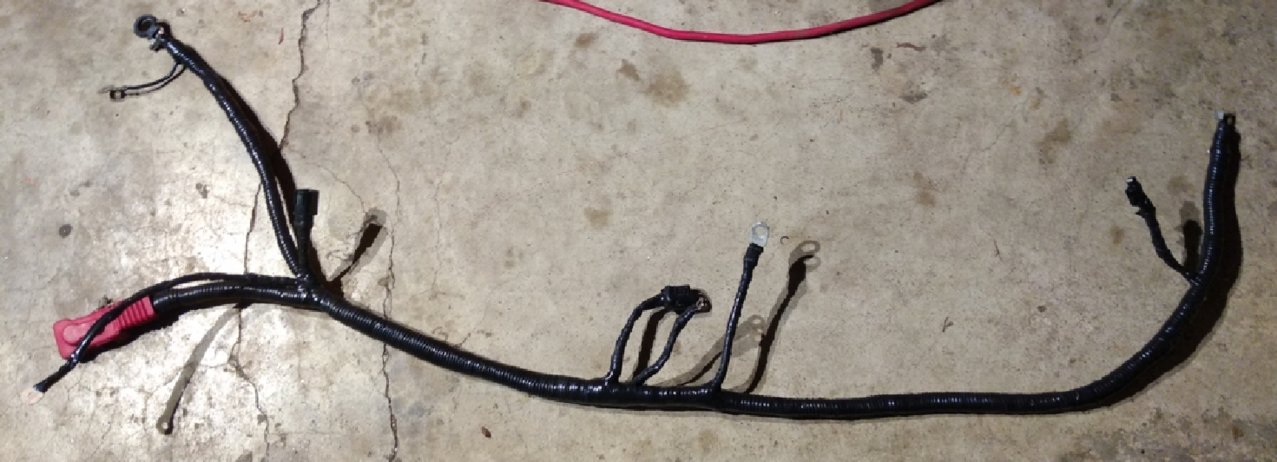

    I removed the old harness wrap, cleaned the wiring, and then rewapped the harness in it using F4 in black.
