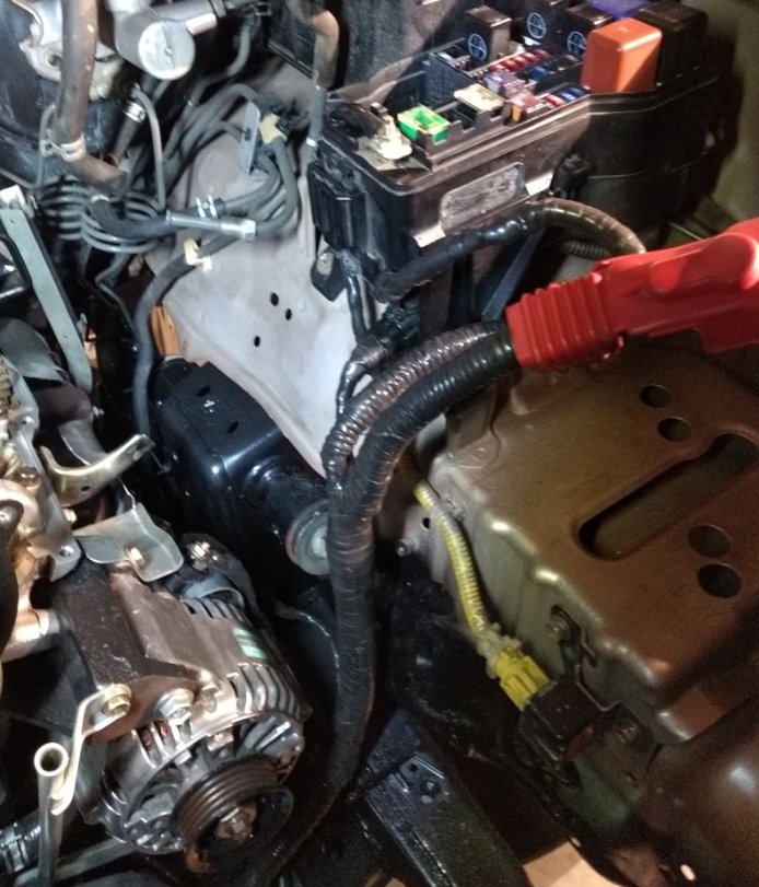

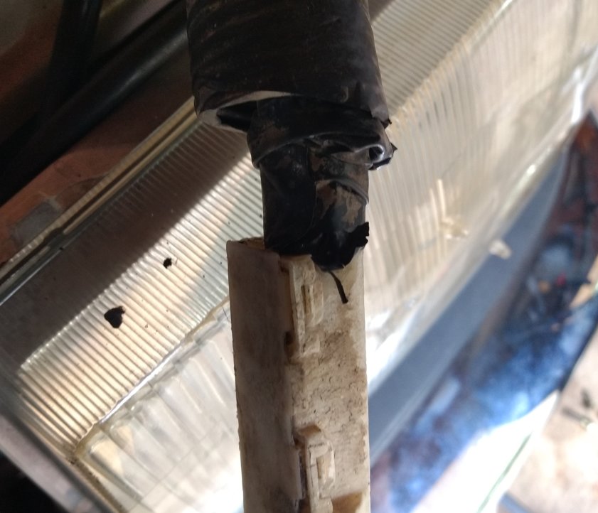

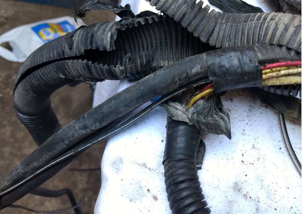

    Yes. The plastic housing was cracking. I pre-wrapped in F4, then a heat resistant flex conduit was wrapped again in F4. I found a lot of oil and grit inside the old wiring conduit.
    From this
    And this.
    To this.
