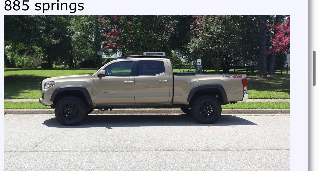

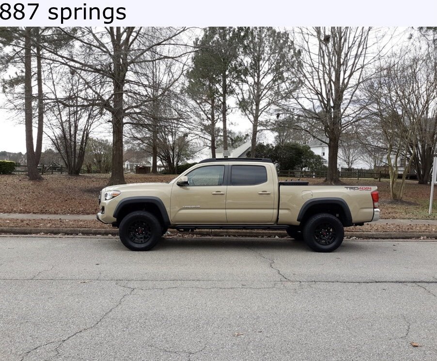

    Here is a comparison that may help..not a 2nd gen like yours but
    E3B89934-B1A4-49DA-B9B4-7E2F062C9283.jpg DAD749E5-4B4A-4B68-92A5-CAD4E2F44502.jpg
    71tattooguy likes this.

    @908tacoma Thanks for the info. Pictures are great! My wife explains a lot to me with red crayon. :rofl: 885s might be my answer, although 887s might be my answer. Much appreciated.:thumbsup:
    908tacoma likes this.
