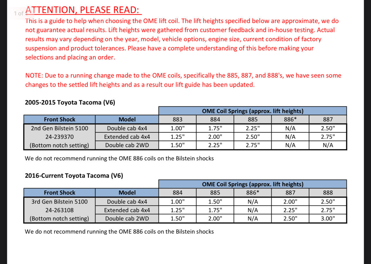

    41,570
    I broke the weld on my trd skid plate this weekend and knocked the fuck out of my alignment.
    The 5100's on the 2nd notch of a stock spring and a add a leaf in the back will serve you well. Just don't over do it like you are in the baja 1000.
    Black DOG Lila and TnShooter like this.
