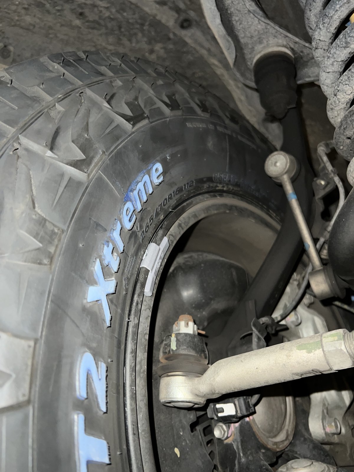

    I’d like to see how much weight is on each tire/wheel. Also if the tires have red or yellow dot on them I’d like to see where they located those. Also did they use perimeter weights on both sides or are the wheel weights on the inside of the wheel?

    It looks like they have perimeter weights on there.
