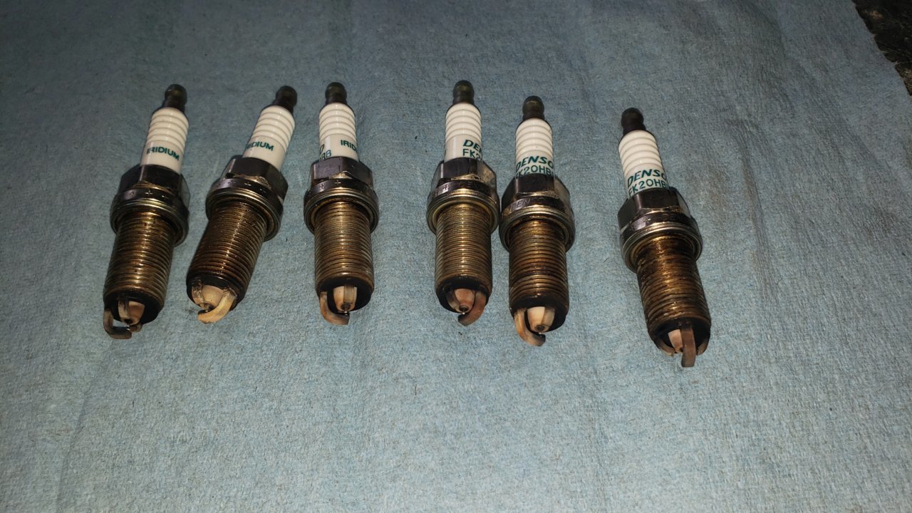

    I took these out at about 55,000 miles. It's not super easy but it's doable with out a lift and nothing like one of those 1980's Cadillac monster v-8's.

    Why the iridium plugs, is that what Toyotas use? Or are they standard copper from the factory?

    That's what was in there. I got this 2017 in 2017 from the local ford dealer. Truck had 15,000 miles on it. I bought the spark plugs that I replaced these with from the Toyota dealer in Surprise Az. The two sets of spark plugs were the same brand and series number.

    Toyota uses Iridium Spark plugs. Platinum tipped plugs are designed for 60k miles, Iridium is designed for 120k.
    There are two part numbers on spark plugs. There is a Toyota 10 digit part number and there is a variable Denso part number. So you need to know which Denso spark plug you are using.
