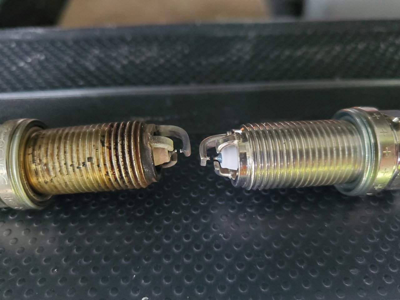

    I put off replacing mine until 80k, but should have checked earlier because one was visibly bad and the boot looked affected too. Replacing 6 myself wasn’t that bad - couple hour job

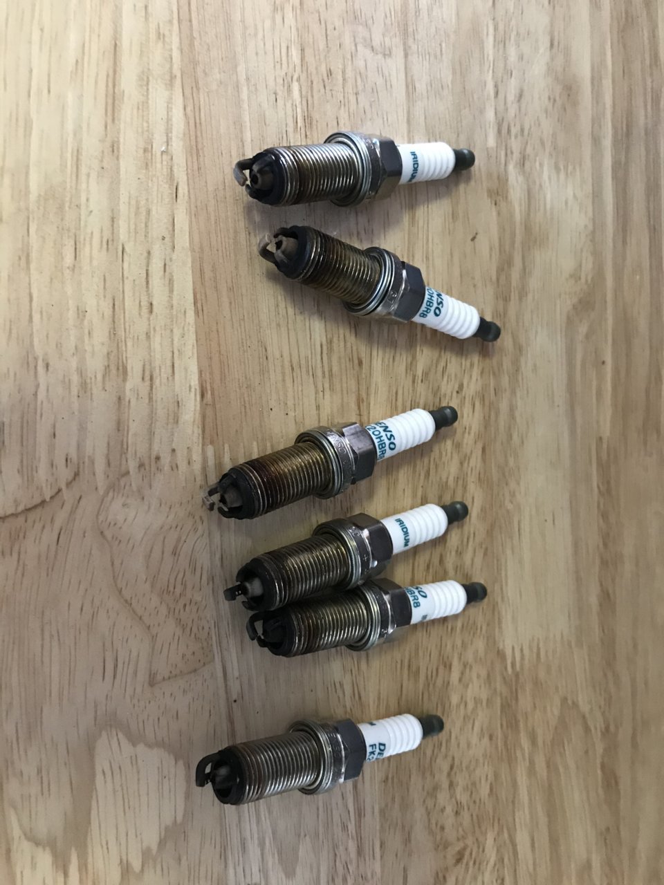

    I bought Denso plugs at Auto Zone. I had $10 off $50 or more. My plugs came to about $10 something each. I changed them at 50K miles. I figured for $60 dollars why not change them early. I did the driver side first because I wanted to finish the job on the easier passenger side. Change your plugs when the engine is stone cold. Came out easy and went back in easy.

    Yes, good point. BTW, my old plugs were torqued properly at the factory. Some TW members reported their old plugs were loose.

    Pull a couple, inspect them.
    Personally, if I’m pulling plugs at 60k to inspect, just throw new ones on. Cheap enough.
