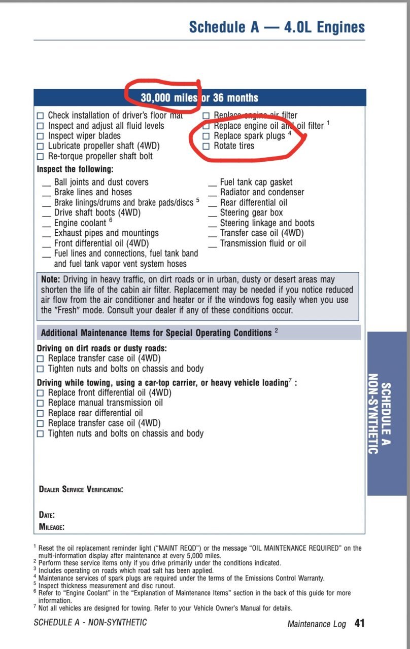

    4.0 in the Tacomas has a 30k interval for plugs, isn’t it?

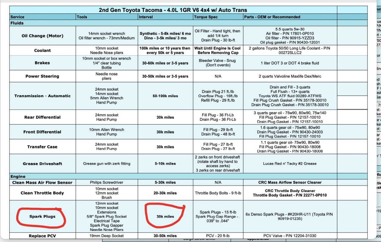

    Well look at that, you're right. The recommended interval is just 30K miles. Interestingly, there's a footnote that say it's related to emissions controls -- in order to get that "as close to perfect burn" as possible, I guess:
