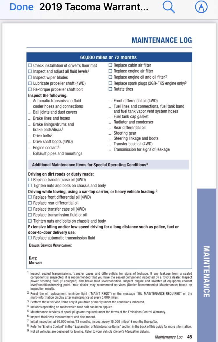

    i think the difference here is that everyone is discussing going over the mileage indicated in the manual, whereas the oil threads generally indicate to change earlier than the manuals indicated mileage.
    overall, i'm one of the guy's that wants to change things before there's a problem. so i run my oil to 3-5k, and i'm also watching other consumables for early replacements. the manuals indicated mileage is there to protect toyota. they're never going to argue about an increased replacement schedule because it still falls under their requirements, it just means i'm paying more per-mile-used for maintenance than someone following the manual. but what i gain is peace of mind that things aren't being run to the very ragged edge of useability, even if it means that toyota already factored in a safe limit, and i'm nowhere near that ragged edge to begin with..

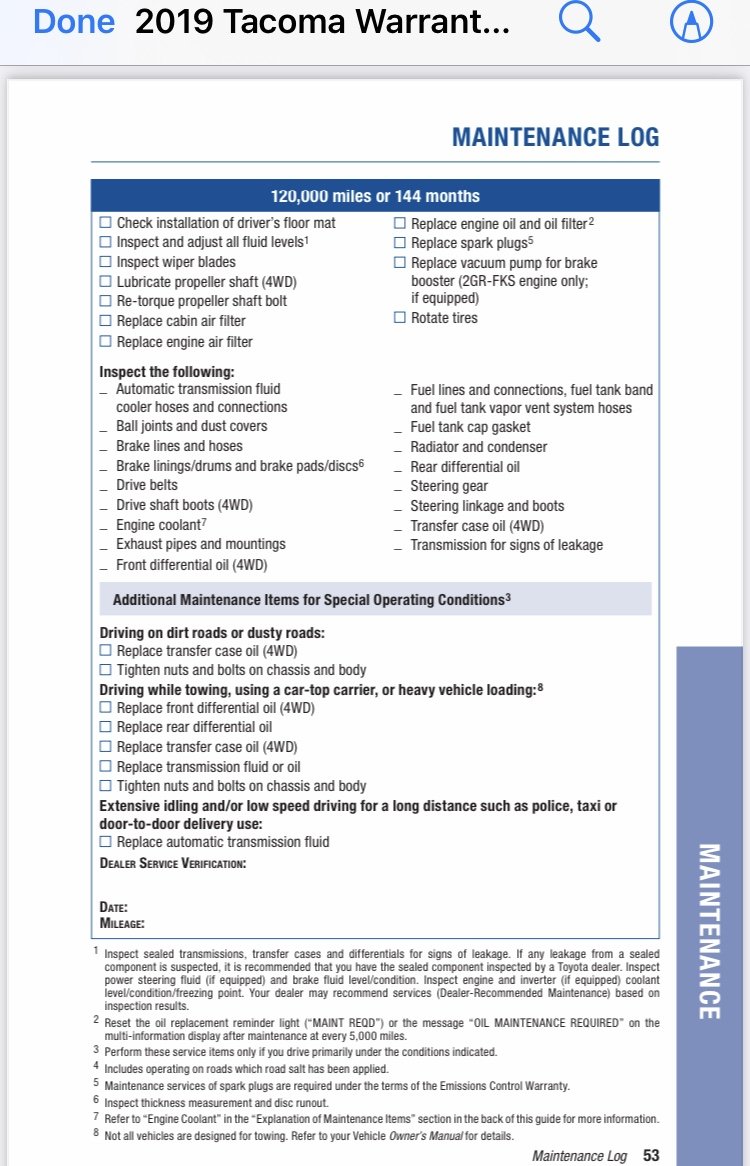

    Yes.
    pickup truck
    If you replaced your plugs at 60, as suggested in the attached document,you don't need to replace them until 120. Because 60x2 is 120. The suggested replacement interval is still 60k. What am I missing?
    *ah ....FKS
    davidstacoma[QUOTED] likes this.

    You got it, 2TR-FE 4 cyl recommended change interval is 120k miles. Weee special. :D
    golfindia[QUOTED] likes this.
