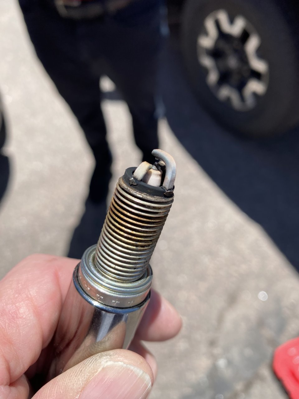

    Just turned 60K. Pulled the plug on cylinder 5 (I think... the one closest to the dash on the passenger side). Here is what it looks like. Any advice? Thanks.

    Good for another 40K

    Did my plugs at 70k and wish I had done them sooner. Two plugs were finger tight (loose) with one getting some blow by. The plugs themselves looked good but once you’re that deep in the project just replace them. Do them at 60k just to check the factory assembly. A doable job, watch some YouTubes and get a wobble spark plug socket.
