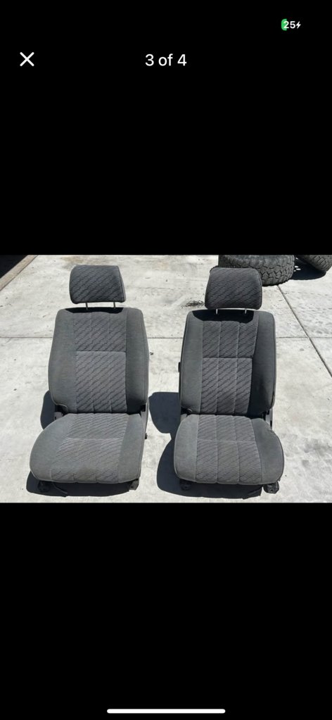

    Supposedly out of 2nd gen 4Runner. Do they fit my truck?

    Fit, sure.
    Bolt up with no modifications? Unlikely.

    ah okay. Can I put my rails on those seats?

    Do you know how to weld?

    This.
    1st Gen truck seats will fit 1st Gen trucks - everything else will require hands on work with the exception of 3rd Gen 4R seats (custom angled mount for one of the feet).

    is it a lot of work? I daily drive this so I can’t have it down long.

    If you really want the seats give it a go on the passenger side and you can gauge how long it will take on the drivers side so you aren’t without a vehicle.

    If you want this to be a quick swap, one option is to get the seat adapters from Corbeau without the sliders. Make all your modifications ahead of time and then when your ready just pull your factory seats and install your new setup. To get my seats in it took about three hours of modding and painting the brackets but only like an hour to do the actual swap.
    https://www.tacomaworld.com/threads/325i-seat-swap.859007/
    This would also allow you to swap to any seat in the future.

    One of the main issues with those seats would be the seat belt catch unless it has a place to bolt on the existing one.
    3rd gen 4runner seats are nearly a direct swap. Only 1 hole doesn't line up on each one, and you can maybe purchase an adapter from a seller here.
