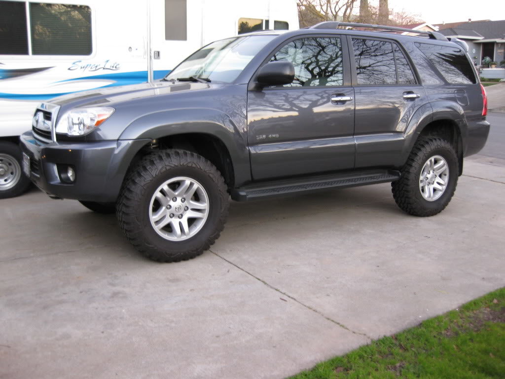

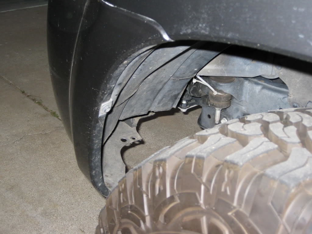

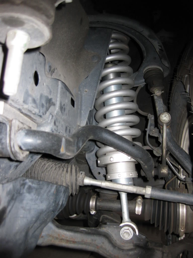

    No matter what, you're just going to rub the sway bar with a 5" BS and maybe the frame at full lock/compression. I squeezed 285's on my wifes 4th gen runner with factory Tundra wheels (also have a 5" BS). I've driven the shit out of her runner at Pismo before and it did ok. Just tried to avoid full lock. I have the Toytec coilovers on the runner is set at 3" right now, but there are definetly shiney spots on the sway bar.
