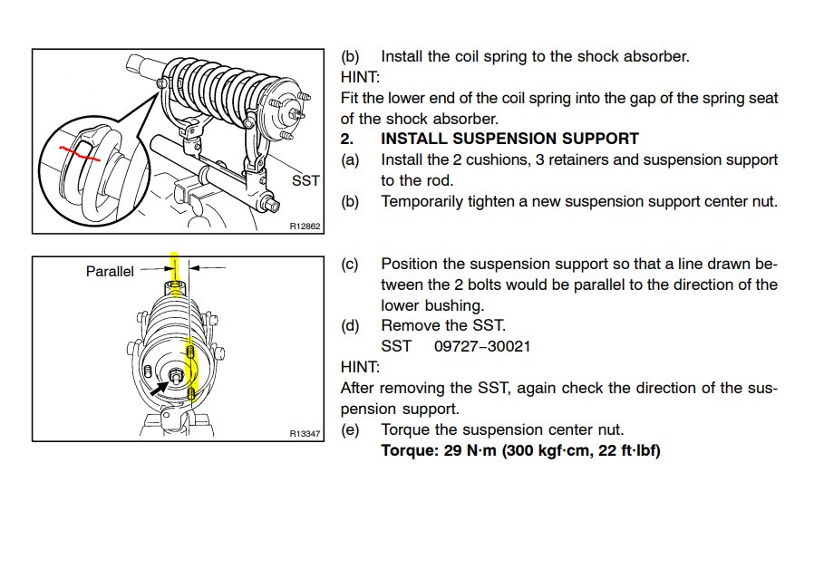

    You line up the top hat in the correct orientation when assembling you won't need to rotate the shock body. Why/how would you "lock" it? Once you uncompress the compressor after assembly, it's under such immense pressure, no way in hell is it going to move during shipping. Unless I'm not reading what you wrote correctly :notsure:
    You hold the bottom portion of the shock body as you are compressing it to ensure the top hat doesn't shift on the spacer/top washer as you compress the spring. They didn't do that. They cranked it down and then zipped it up with the impact once the top nut was on. It wasn't lined up correctly. There was also enough of a gap on the lower seat to make me say WTF were you thinking trailgear tech?

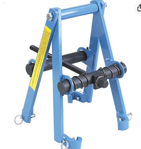

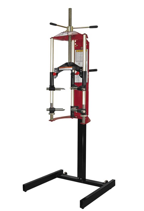

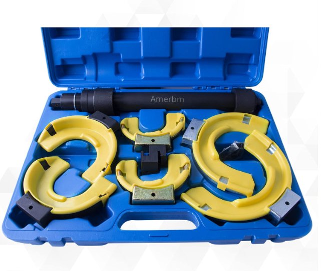

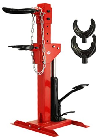

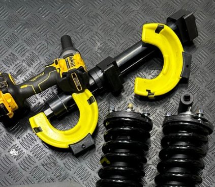

    All good bud, thanks for the offer. Was able to get the job done using this style of compressor. Took a couple of tries to understand exactly how to line it up but its correct now. Aside from the wall mount or a cart mount, this was the only portable I was willing to trust. If I was able to do it with a portable, no reason it couldn't have been done correctly with a professional compressor by someone paid to do it all day.
    What I used -
    Ideal but costly -
    Branick 7600 w/mobile cart
    A neighbor had an old style OTC which simply would not come close to fitting the coils, tried and tried but just couldn't get it to hook on to the coils.
    Also tried another old one he had and that was utter crap since it was completely flat at the bottom. You'd have to shim the coil and I just didn't feel it was safe enough. Looked like this but again, it was quite a bit older and the bottom mount was not offset.

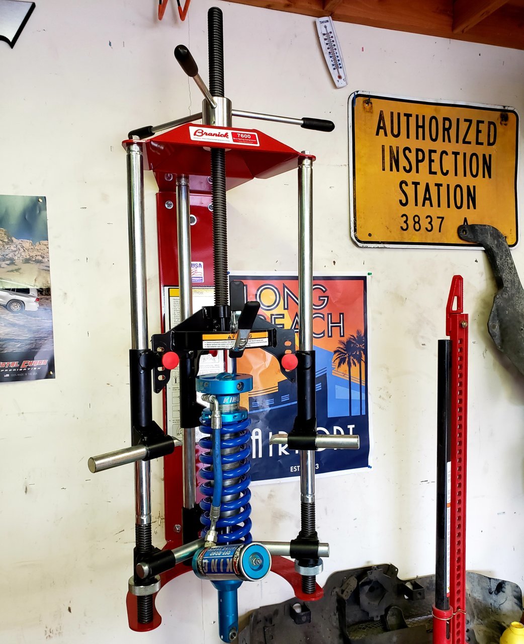

    I own a branick 7600. Truly the best way to do it.
    The last one you pictured I completely bent on the first use of doing 6112 bilstein. No one should buy that thing.

    If I knew I'd use it often enough, I absolutely would have that Branick. Yeah, that last one was utter crap. Apparently my neighbor had it leftover from his auto mechanic school days. It was one of the first specialty tools he had bought. Maybe would be fine for an old school 80s honda but now, nope - no way. I should've taken a picture of it lol.

    Haha. Yeah Tacoma coils actually require quite a bit of force to compress. I have the branick at home for my side jobs. At my day job (mechanic) I'll typically use the spring compressor you ended up using. They work pretty good.
