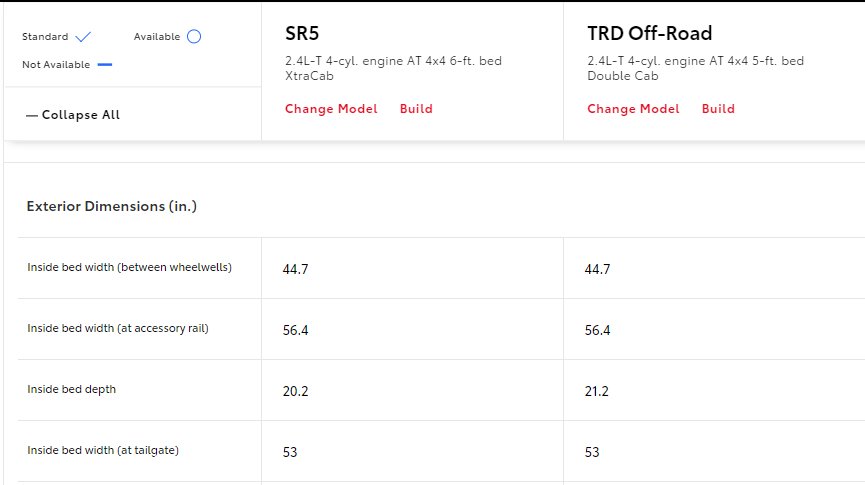

    From Toyota's own spec sheet on their website. It's a start.
    Roadkill69 likes this.
  13. Feb 26, 2024 at 12:49 PM
    #33
    Roadkill69
    Roadkill69 Well-Known Member
    Aug 22, 2020
    #338492
    141
    1998 Xcab 4x4 SR5 V6 TRD-OR; 2021 TRD-OR ACLB
    @stk0308 , good find! Accessory rail is closer to top than the base, and the sides do flare out.
    I just found a single 24 SR5 on a dealer lot 10mi from me. Was gonna drive over today and measure, but if I dont get to it, this helps!

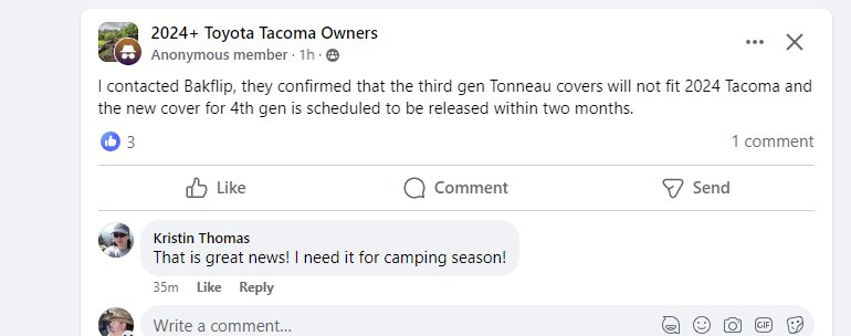

  14. Feb 28, 2024 at 10:19 AM
    #34
    JB_TN
    JB_TN Well-Known Member
    May 22, 2023
    #425186
    2,053
    JB
    Tennessee
    2024 Bronze Oxide TRD OR
  15. Feb 28, 2024 at 11:13 AM
    #35
    Roadkill69
    Aug 22, 2020
    #338492
    141
    @JB_TN thx. I'm hoping that since my camper sits on outer edge of my bed, and has flats extending inwards, that it will still be properly sealed and supported on 4th gen. It will be a matter of an inch or two, hence the measurement. I can't believe how hard it is to get this top of bed rail width, considering how many people have toppers and tonneau and campers and bed racks, all requiring to know that width. You'd think one of those aftermarket companies would have measured and have it on their sotes, but I've looked at 30 or so and can't find it.
    Instead, every post has track width and wheel base, which affect absolutely nothing else, and anyone will just take it as it comes.

  18. Mar 14, 2024 at 6:47 PM
    #38
    RangerFan
    RangerFan Well-Known Member
    Feb 27, 2024
    #444818
    57
    2024 Tacoma TRD Sport
    Here's what I found on my 24 TRD Sport with 5' bed.
    Measuring outside to outside of bed protective top cap at front is 64"
    At tailgate is 61" (gets narrower from front to back)
    64½" from front of bed to back of tailgate protective top cap (on top)
    Bed is 52½" W x 60½" L inside bed dimensions
    Bed is 20¼" deep and 39" from bed to top of cab
    The contoured lip sticking out at back of cab at roofline sticks out 1½"on the sides and curves out to 2½" in the middle
  19. Mar 15, 2024 at 1:41 AM
    #39
    Roadkill69
    Aug 22, 2020
    #338492
    141
    Do you have the INSIDE bed width, at the top of rails? You gave the tapering outside width, but it is the inside width that determines if a topper will sit on it still, or a camper shell. Thx!
