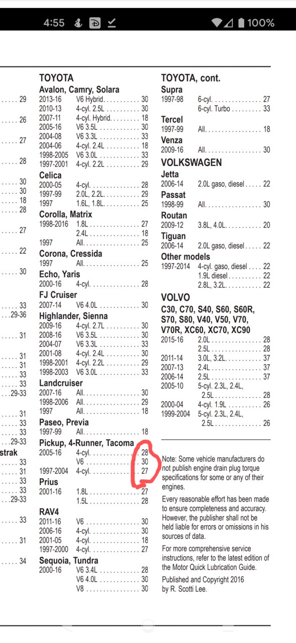

    What’s the torque spec for the drain plug?
  6. Sep 9, 2021 at 9:52 AM
    Das it mang
    Das it mang Well-Known Member
    May 1, 2019
    #291938
    6,586
    Az
    1996 T100 SR5 MT
    Stock again- rip slug
    ~ 30 ft lbs iirc
    Andiamo[QUOTED][OP] likes this.

    Please do not torque to 30 ft-lbs.
    Suggest to tighten to "wrist tight". Hand on the ratchet head, use one wrist to make the plug firm. The pan is not under pressure. A gorilla torque is not needed.
    TWJLee and davidstacoma like this.

    Everywhere says the torque spec is 27-30 ft lbs for the plug. The oil filter, yes, u hand tighten

    168,000 miles / 5000 = 34 oil changes. Same plug. 34 crush washers. Crush washer is 10 cents. Torqued to 25lbs. Never leaked.

    Yes, I understand your point and I understand the torque spec.
    Here is a question to think about......
    If the plug is tight enough to not leak, then why does it need to be tighter???
    Bivouac likes this.
  20. Sep 11, 2021 at 7:49 AM
    #20
    Das it mang
    May 1, 2019
    #291938
    6,586
    Az
    1996 T100 SR5 MT
    bc it may back out with use of the vehicle among other variables and start leaking? Why not use the factory recommended specs instead of making your own rules and risk failure down the line?
