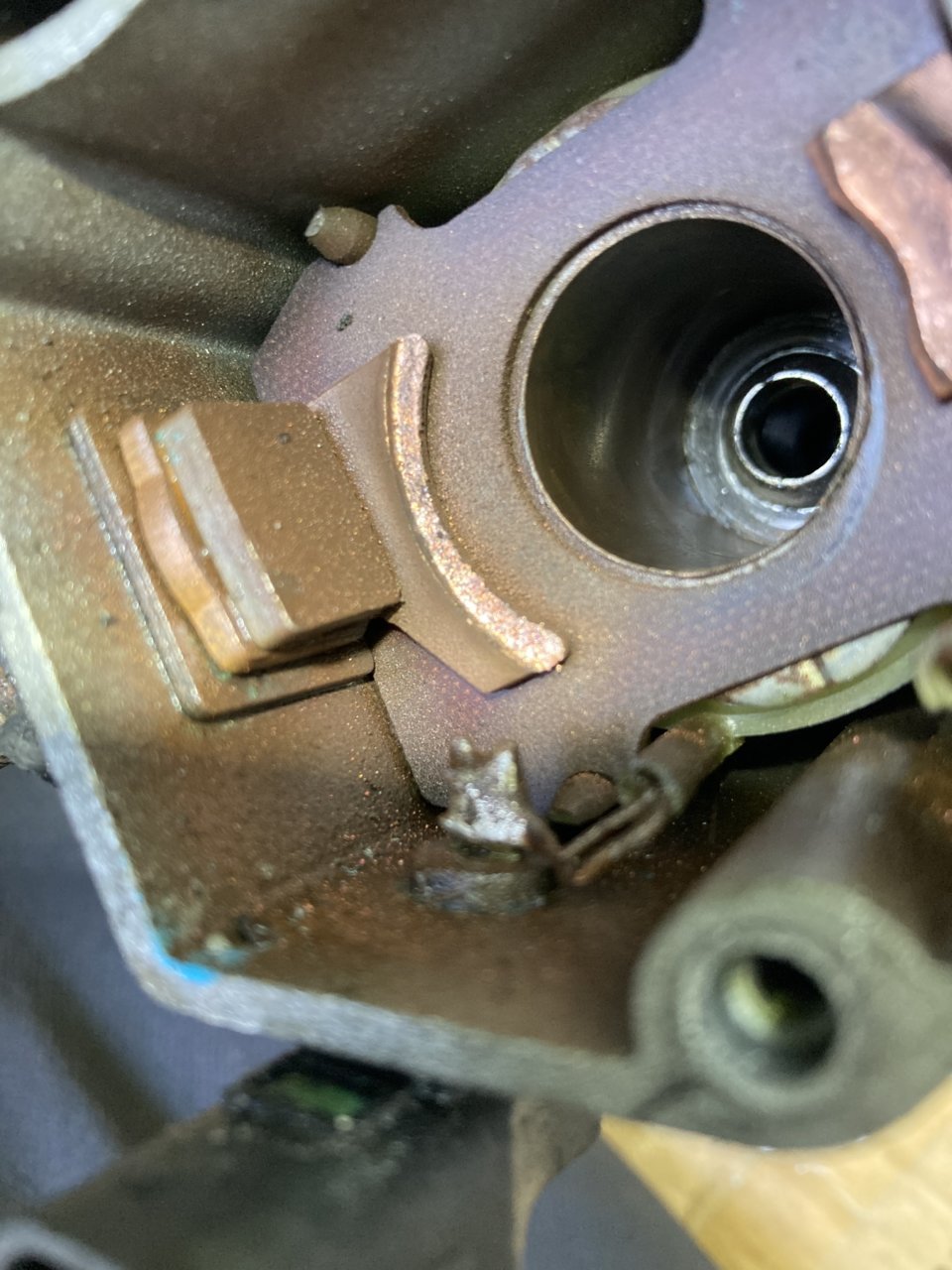

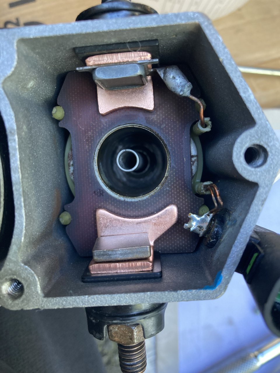

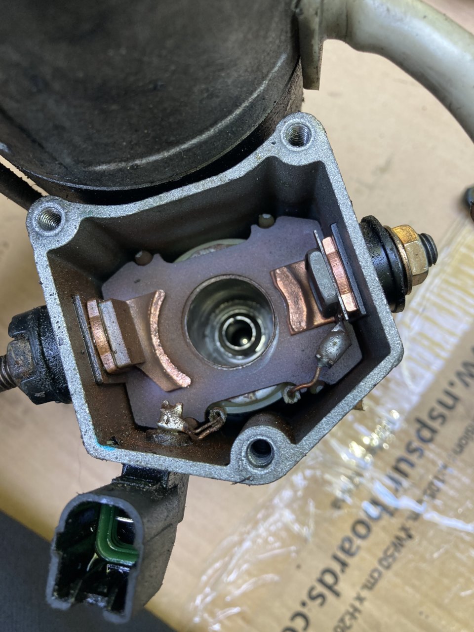

    I pulled my starter out because I have been having intermittent problems with engine turning over. Suspected the starter motor contacts were worn but now that I see them I feel like they’re not even that bad. I could clean them or replace them while I’m in here, but I didn’t order new contacts yet (d’oh!). Should I be looking elsewhere for my intermittent starting issue, or in your opinion are these technically worn contacts and I should replace? Thanks

    Those look odd.
    The kit is cheap, just replace them and the plunger. No need to ask if it's apart already.

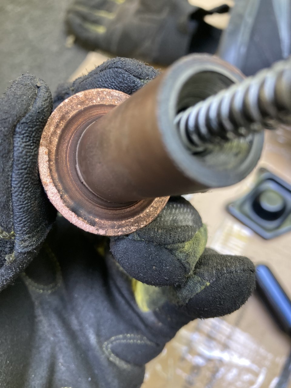

    Plunger is bit dirty, so I’ll definitely hit that with a brush… Also should mention my valve covers were leaking and I only got around to it earlier this year. The starter and all it’s connections were pretty oily so will definitely address that too.

    The kit comes with a plunger.

    Yea good call. Might as well. Couldn’t believe I even got the thing out of truck since mines an automatic…
