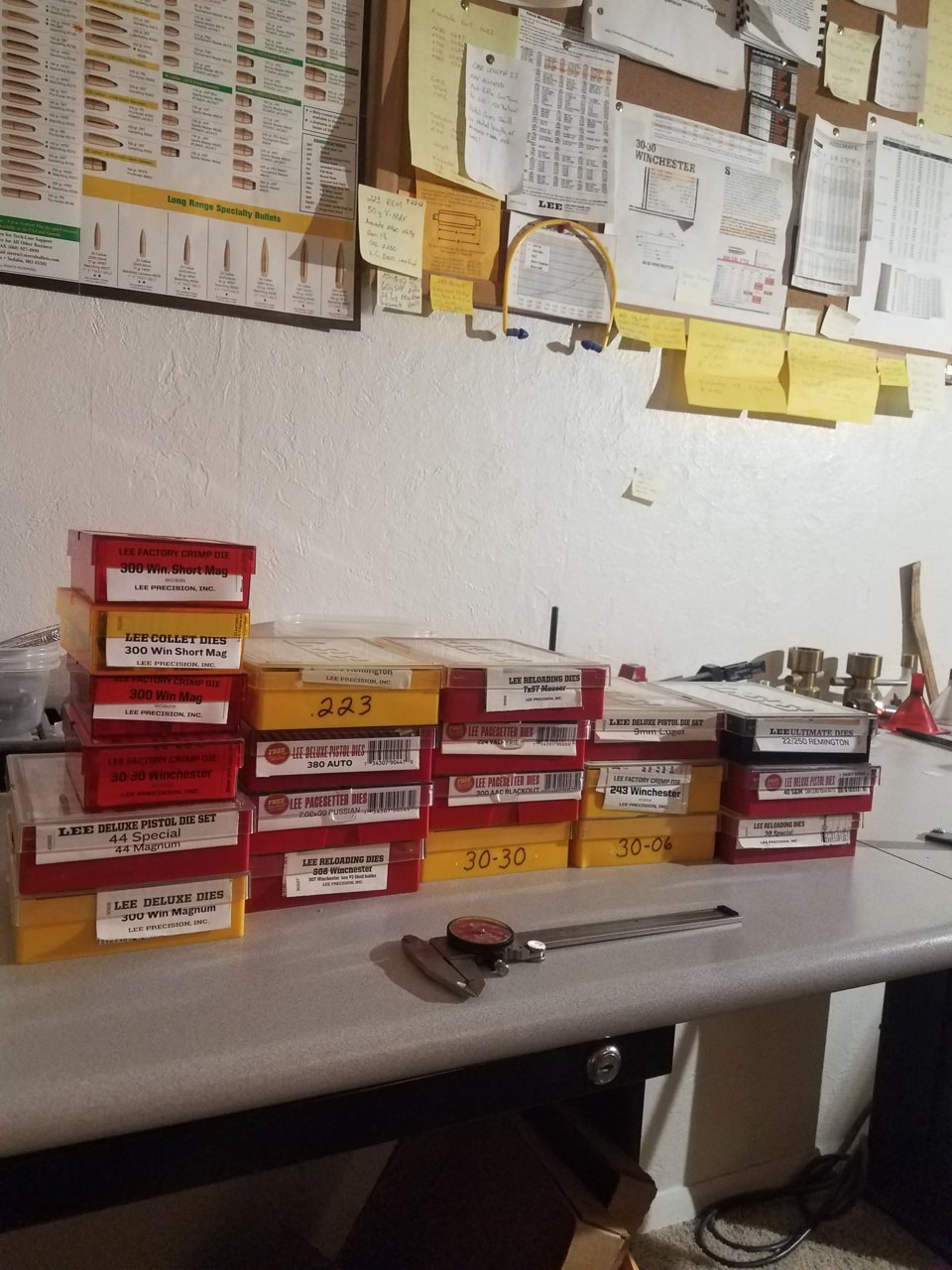

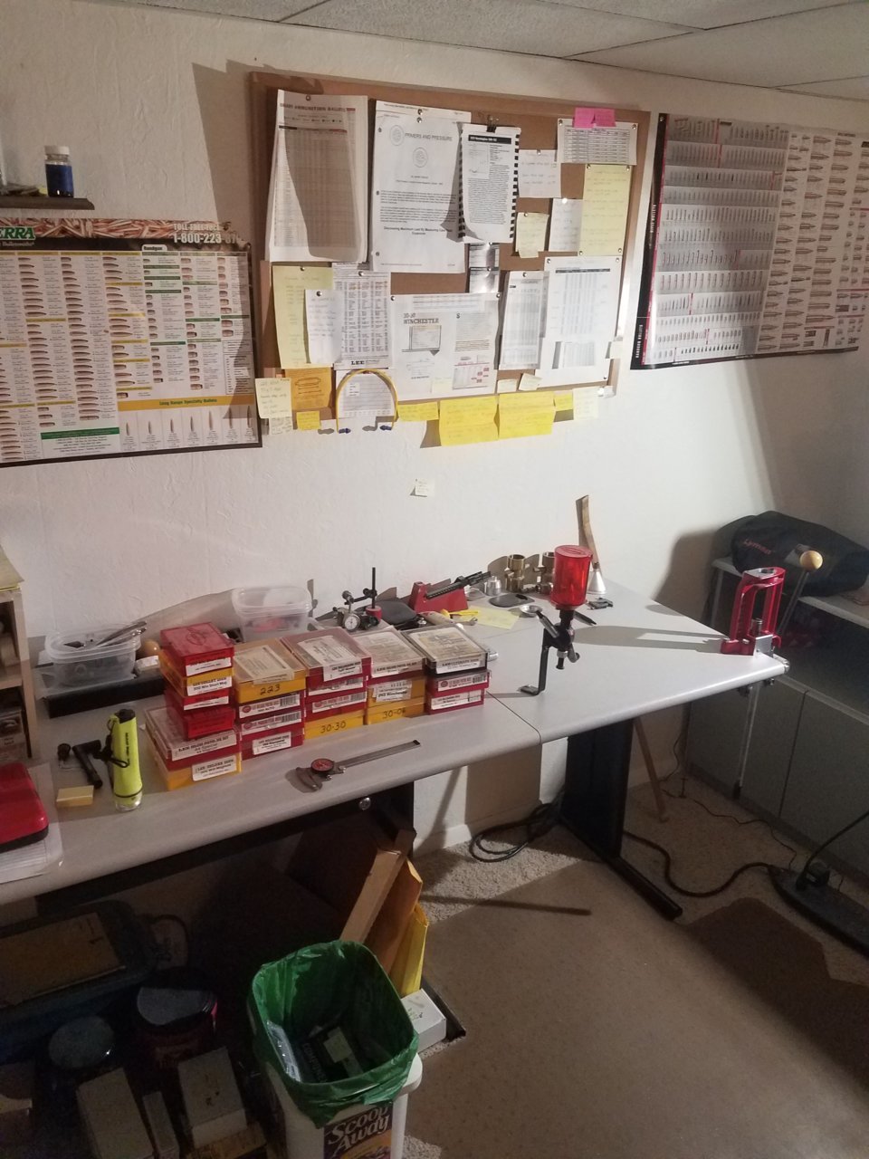

    @Gearheadesw the one thing you might need or that's not pictured is a dial caliper for measuring lengths.20201231_172812.jpg

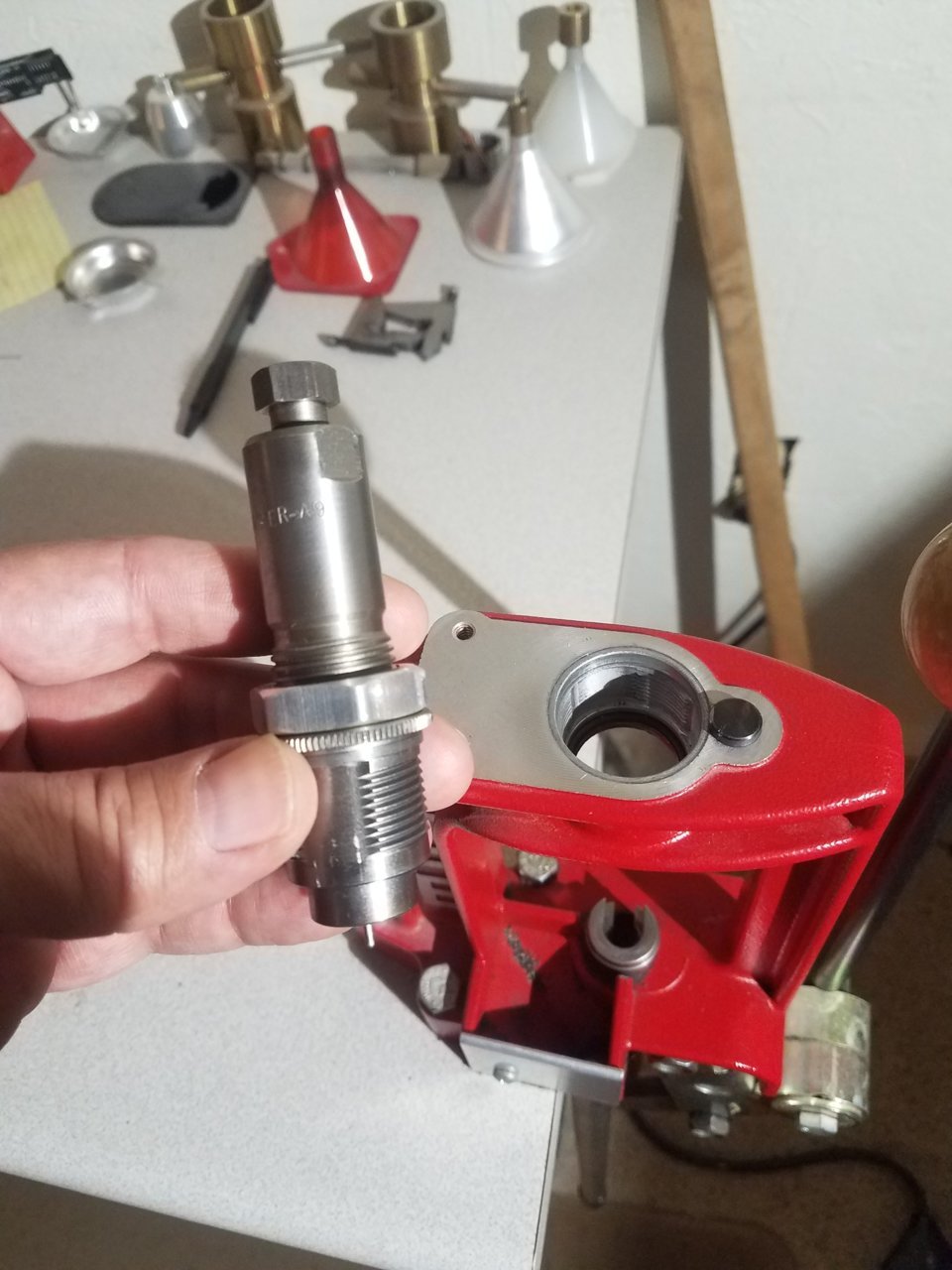

    I'm still slugging away, can any die be used in any press? i.e.. Lee dies in my Lyman equipment?
    I'm really trying to get this going at the worst of times, nothing to be found ring now, sucks.
    Still looking to mount my stuff, figure out how with the room I've got. Still having fits trying to figure out the order of steps, all 900 of them.

    Most if not all die sets use the same standard thread diameter and pitch. My Lee single stage press on the other hand requires their quick change bushings to work. The quick change bushings saves from having to adjust the die every set up. I'll post a picture shortly.

    Given some thought, most die sets probably have a set screw in the lock nut so this die bushing thing most likely a evil market gimmick to sell bushings at $4.00 each.20210101_081855.jpg

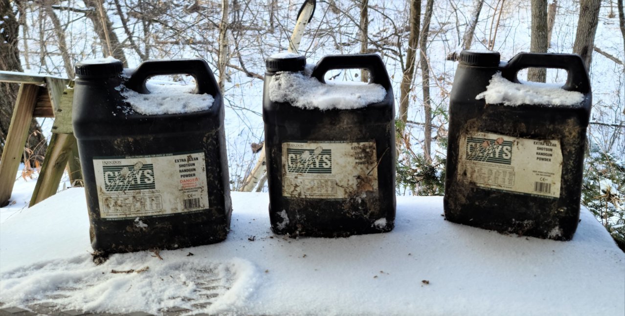

    I love Hodgdon clays and go through a lot of it. The empty 8 pound kegs work great for storing used motor oil.
    Haven't changed my oil myself since got the Taco 7 years ago and just toss the empty kegs in the recycling bin now. Ever wonder what the person that separates recycling thinks when they see them :rofl:

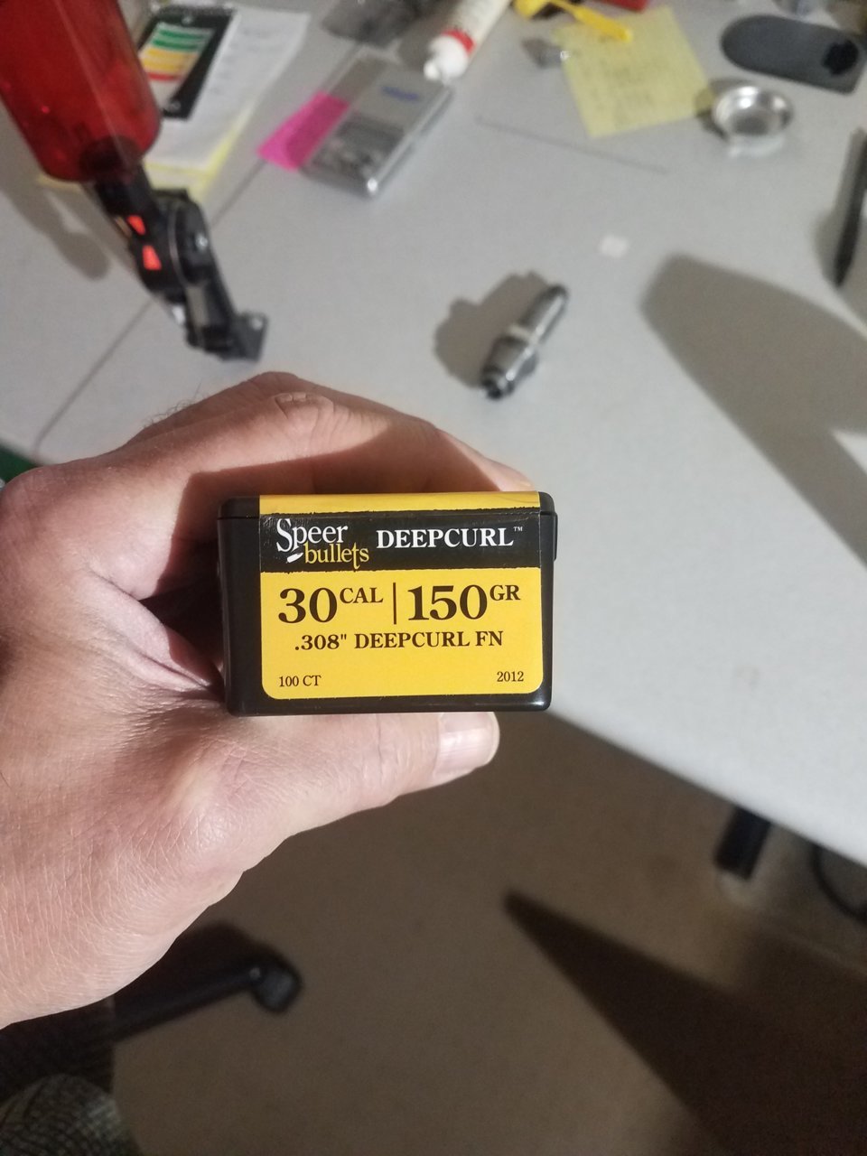

    I use Speer in my Marlin 336 30-30 with max charge of Hodgdon LeverRev. Using data from Speer which is a little higher than most others. No signs of abnormal pressure and good groups. 20210102_195733.jpg

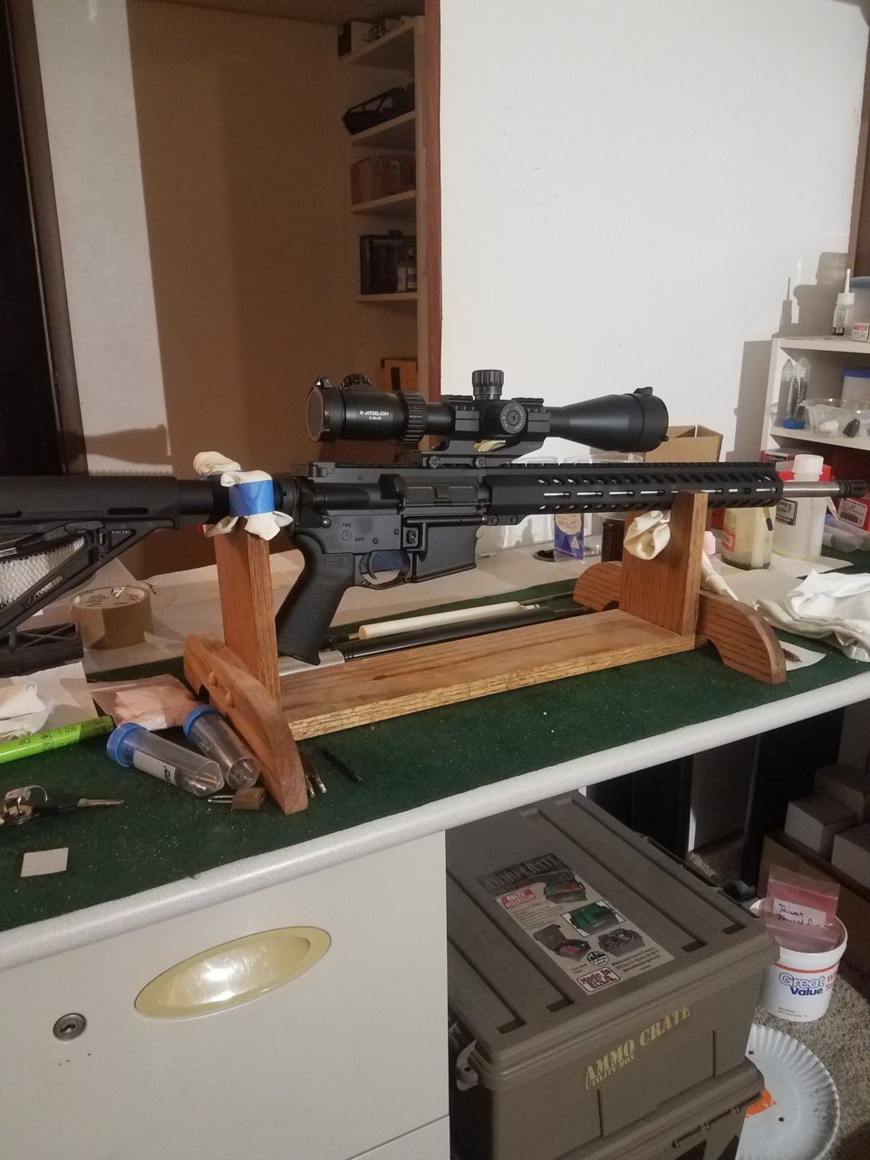

    My latest reloading debacle is trying to get 88gr Hornady to shoot decent out of my .224 Valkyrie. This particular rifle will shoot factory Federal 75gr TMJ very well but I'm getting the feeling that might not have fast enough twist to shoot these 88gr. I hate to waste the bullets so I've removed the tip on several so I can load them out farther. I've compared with ogive gage and still below the factory length ogive wise to the 75gr Federal.

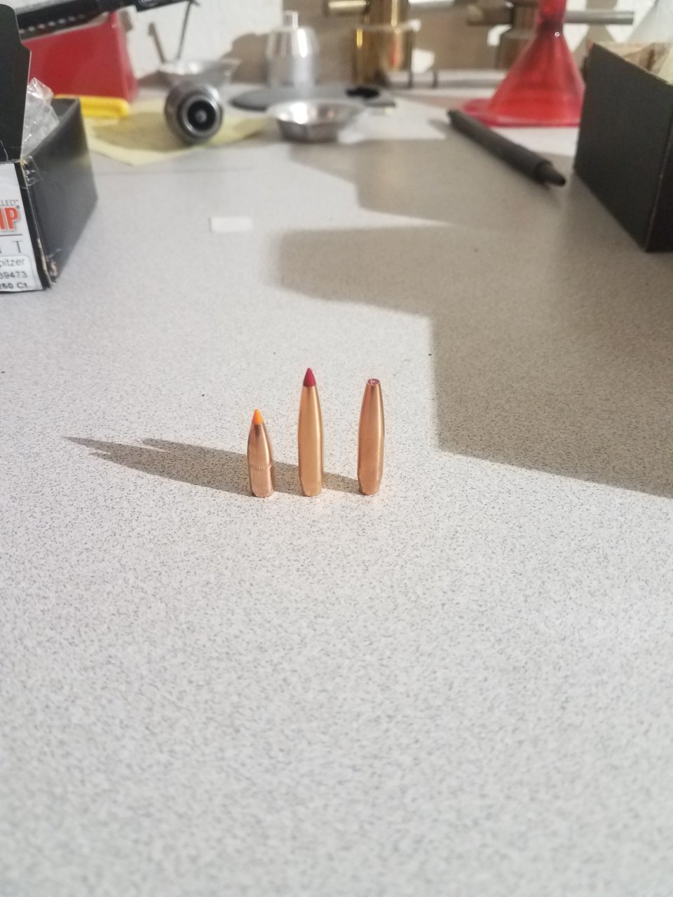

    20210102_201731.jpg 60g Nosler, 88g Hornady ELD Match and same 88g with tip removed. My friend been shooting the factory Federal 60g Noslers said 7 rounds at a 100 yards little more than a ragged hole. He bought his upper receiver right after I bought one, now he wants to buy mine from me...

    .224 Valkyrie is 1/7 twist 20210102_203124.jpg

    The 88g bullets weren't making key holes so I'm not giving up yet.
