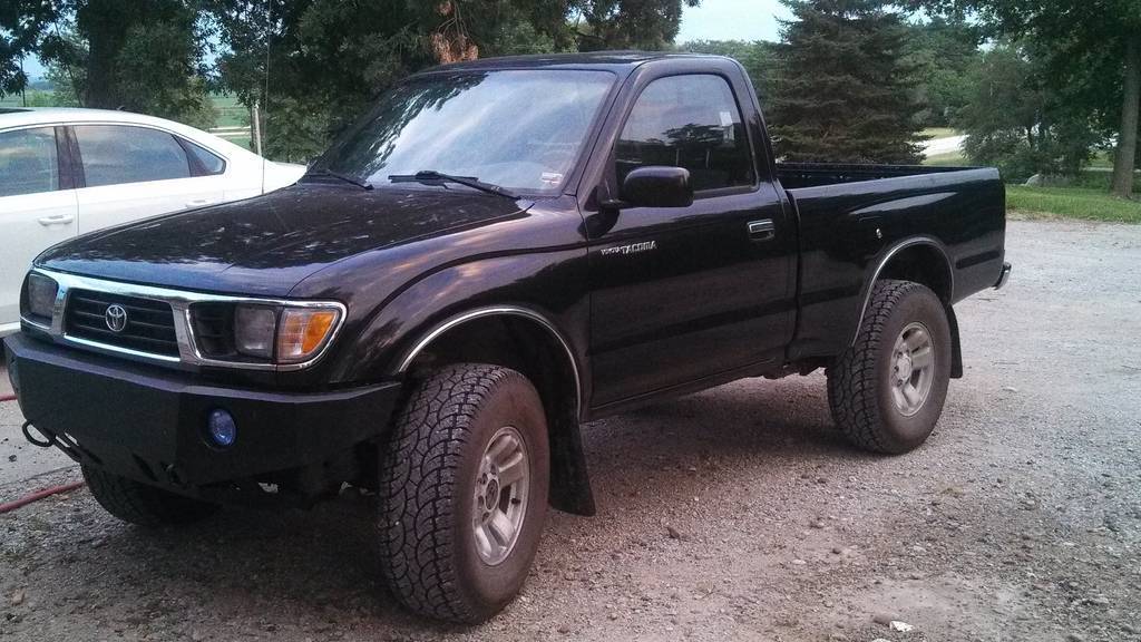

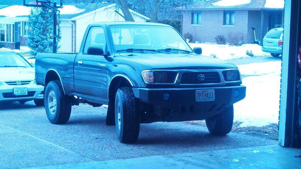

    Here is the bumper me and my dad made.

    you and your dad built that from scratch? looks clean man. nice straight even and semetrical. good job:thumbsup:

    Thanks. We mocked it up with some cardboard and duck tape first. I was even surprise how straight it came out.

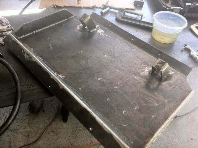

    I made a skid plate and rear shock mounts. Working on a rear bumper..

    that skid is fresh! i need to build one as well. what kind of sheet metal did you use(how thick)? also i want to relocate my rear shocks too, atleast until i decide to do long travel coilovers and build a trailing arm. do you have any tips or is there anything i should watch out for when i go to remount my rear shocks?

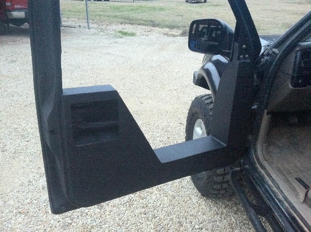

    I'll contribute. I built my half doors, skids, and bed rack. Here are a few pics.
    01380064-B1F0-4BB1-9F4C-139377E1A7E5_zps_c368c93ca7ad6c7dbb43d78ac3bf1a8723db5866.jpg
    73F5FF16-3F57-4D7D-9150-F75058A1BA1A_zps_dca098655a79993bb1b92b56bf54b737b0a6179d.jpg

    awesome work man those doors are bad ass. i wouldnt mind a pair to sport on my ride during the summer time after i finish the cage.

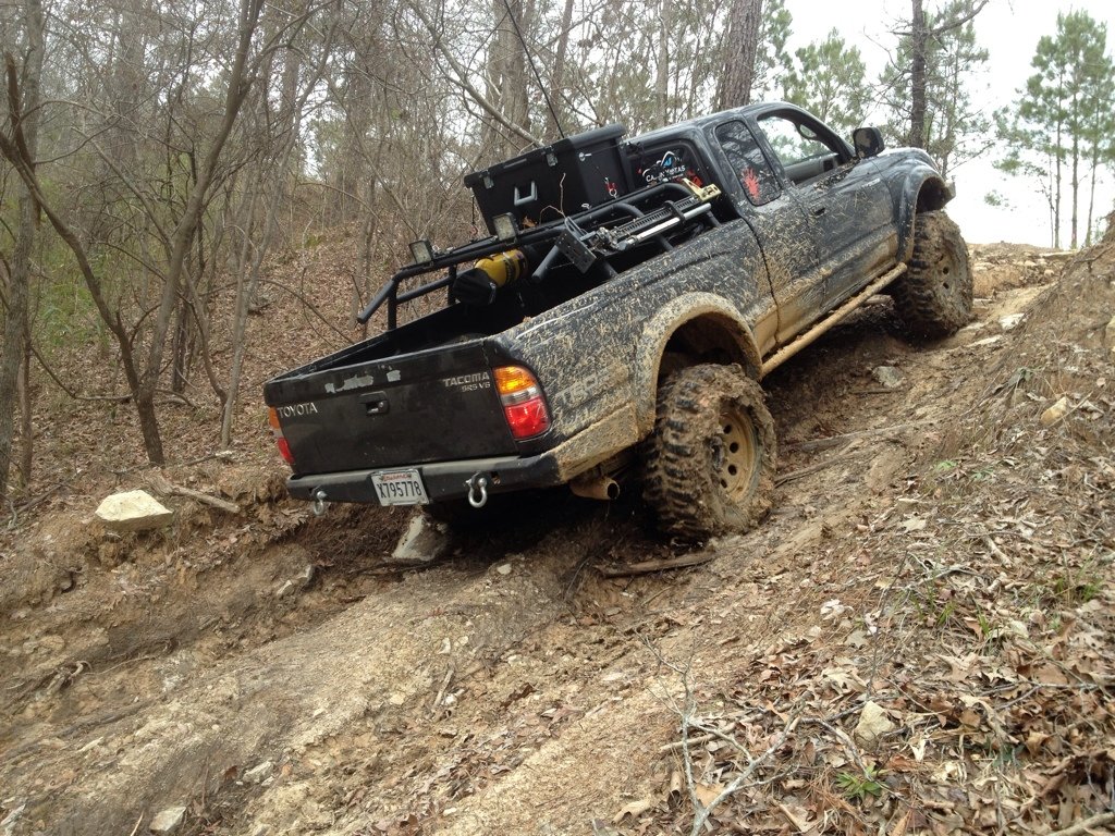

    ...too much shit to list.
    Bedcage with service for dual spares, gas cans, and floor jack
    5E19A825-CF33-4318-9236-E3C08168AA57-482_ceda3ea5260fd24c438d87f1f34bb82f6397b97d.jpg
    31F98A63-A7F2-42CE-BBC3-5EA4CC86DF88-121_7122a968b5ebb362a1bb8df35ddada46ca33fb89.jpg

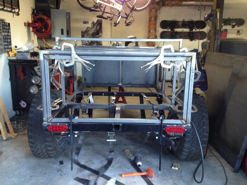

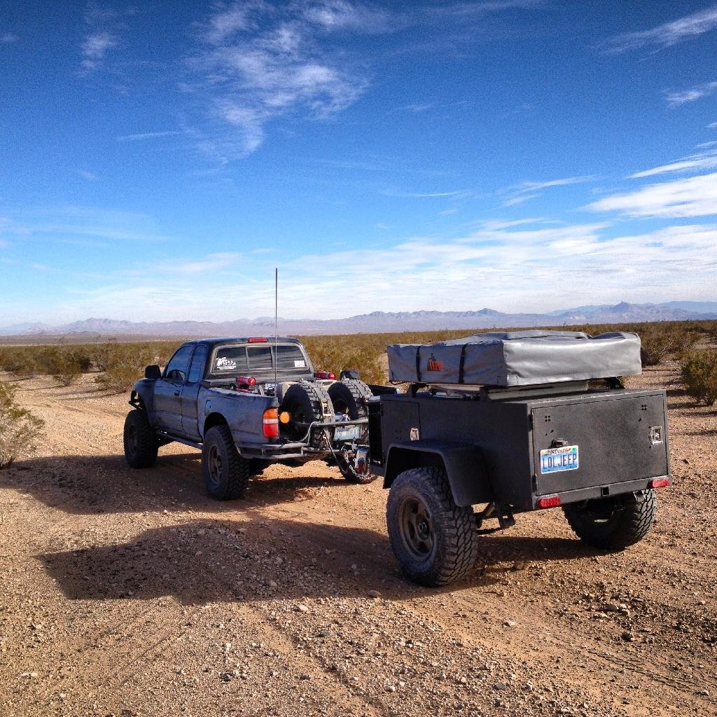

    And expo trailer built from scratch:
    6B45A1EA-A2C9-4D1A-9508-1BFF6C4CEB7D_zps_89d4f4b87696e6249a57f40c9e2a1aed6f61fbc0.jpg

    Skid is 3/16" plate with 3/16" 1"X2" tube.
    Make sure you have at least 2-2.5" of travel with the suspension fully stuffed and full droop. If you want I can email you pictures with the measurements I used.

    nice work man i can tell youre well equipped with tools and know-how. What leaf springs are you running in the back?
    and are you going to cage the inside of your truck too?
    by the way, that trailer is f*ckin awesome matching rims too, makes it look super sick. but the license plate my friend is the icing on the cake hahaha :yay:.

    It's a 50t pack...mostly.
    Cage is coming this year after my Moab trip. I started collecting parts. Have the seats already, just need the time.
