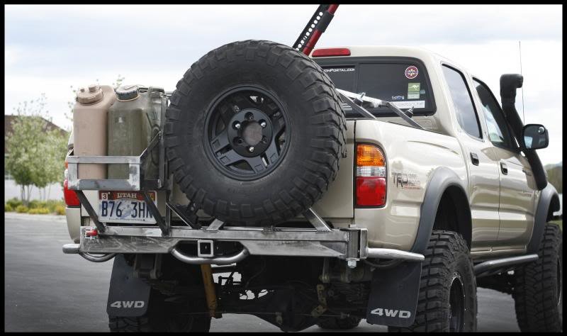

    Built a bunch of bedracks for people including my own.
    rear bumper w swingout (this one for a customer)
    My rear bumper.

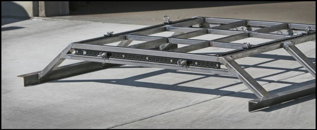

    Flat roofrack

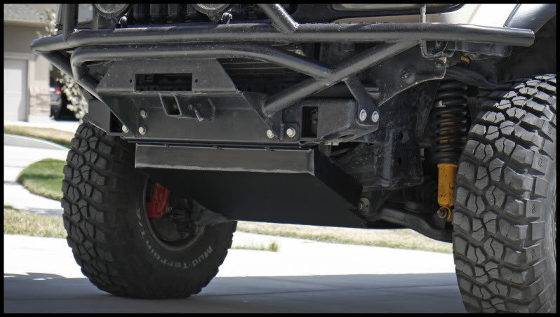

    Full skid plates

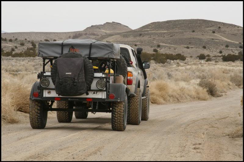

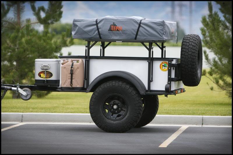

    Scratch built trailer

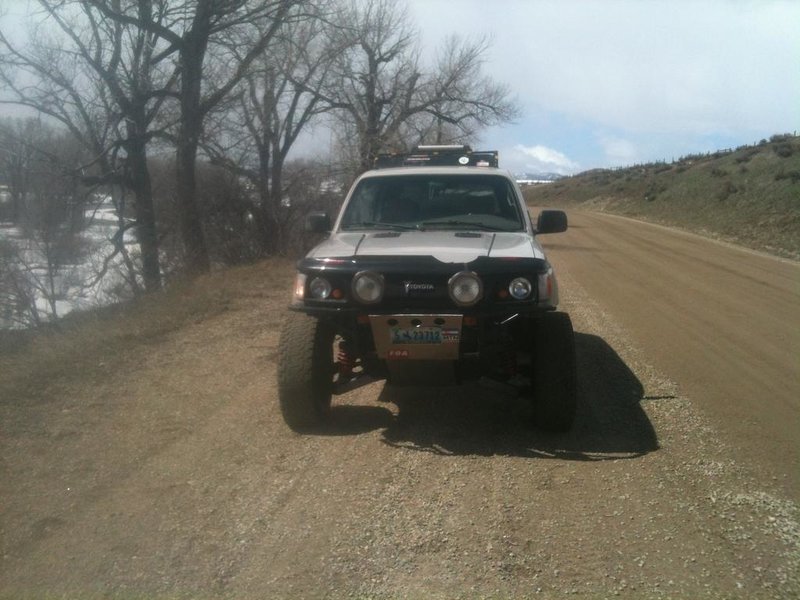

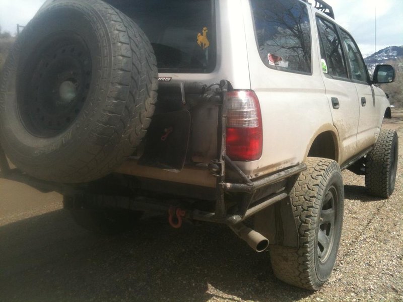

    front long travel, camburg, dual shocks, pre runner front bumper, swing out rear tire,
    built bumper 1.75 dom, and 1/4 aluminum skid, and just finished custom mesh grille with 1980 logo, decided to put in some hood louvres too. as well as rear bumper made out of stock trailer hitch and 1.75 dom , tire carrier is tied into what will be a bed cage once i link her up this summer.

    nice ride man that droop on the front a-arms is serious, those arent the stock CV's in there are they?

    974rnr
    974rnr Active Member
    Apr 9, 2014
    #127367
    32
    matt kelly
    steamboat colorado
    97 4runner long travel
    no man they are ones out of the tundra ( for the L/T ) then i modified them to allow for max travel. shes had no problems yet and be L/T for about two years :D

    And yet you've got stock fenders. Which means you either limit your bump travel something fierce, or you don't really "use" your LT. Otherwise you'd have some wicked gouges in your tires.

    haha way a head of you man!! bumping a L/T kit early is just ridiculous, I mean i didn't spend that money just to have stock travel haha, i cut my fenders to get the full travel when i originally cycled my kit kinda like the rock rig guys do, put a lil trim over the cut to make it look ok. but obviously fiberglass front and rear will be needed to build my rig the way i plan to.
