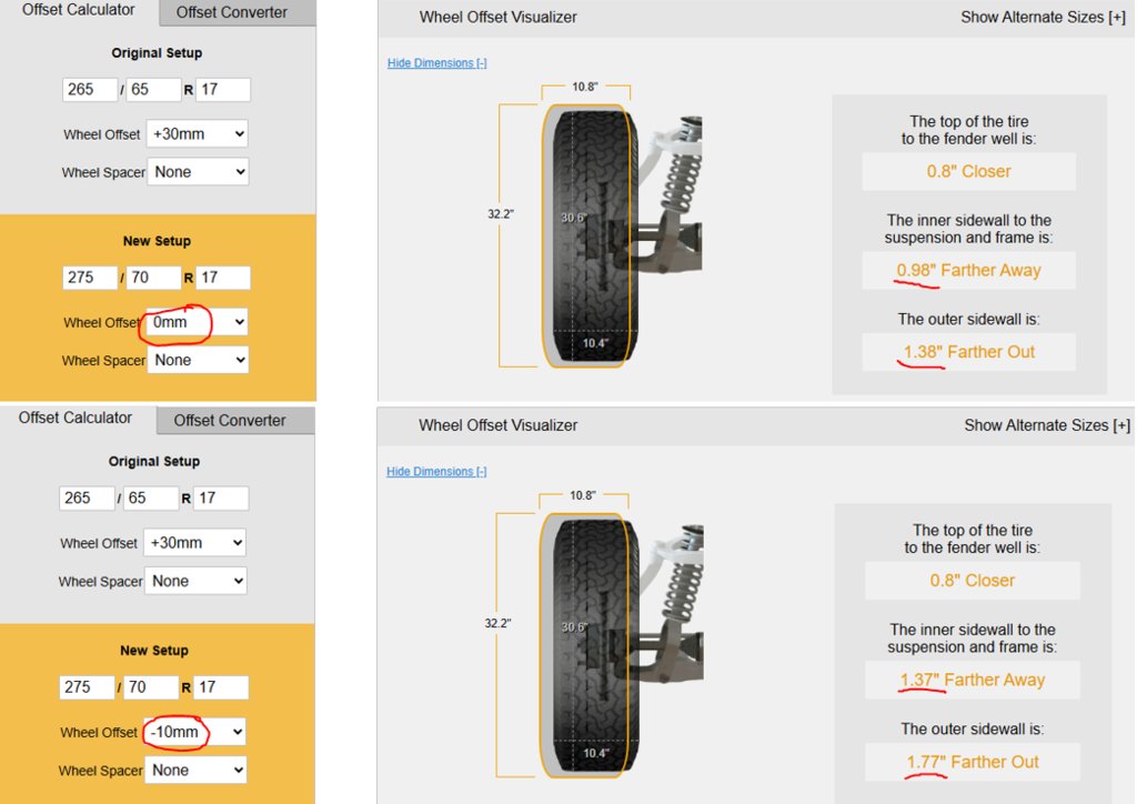

    Biggest tire I'll go with are 285s...and that's a BIG maybe.
    275s are reasonable with my TRD Lift...depending on the "Offset".
    It would more-than-likely be safer to go Zero offset than -10 based on distance from inner sidewall and pokey on the outside.
