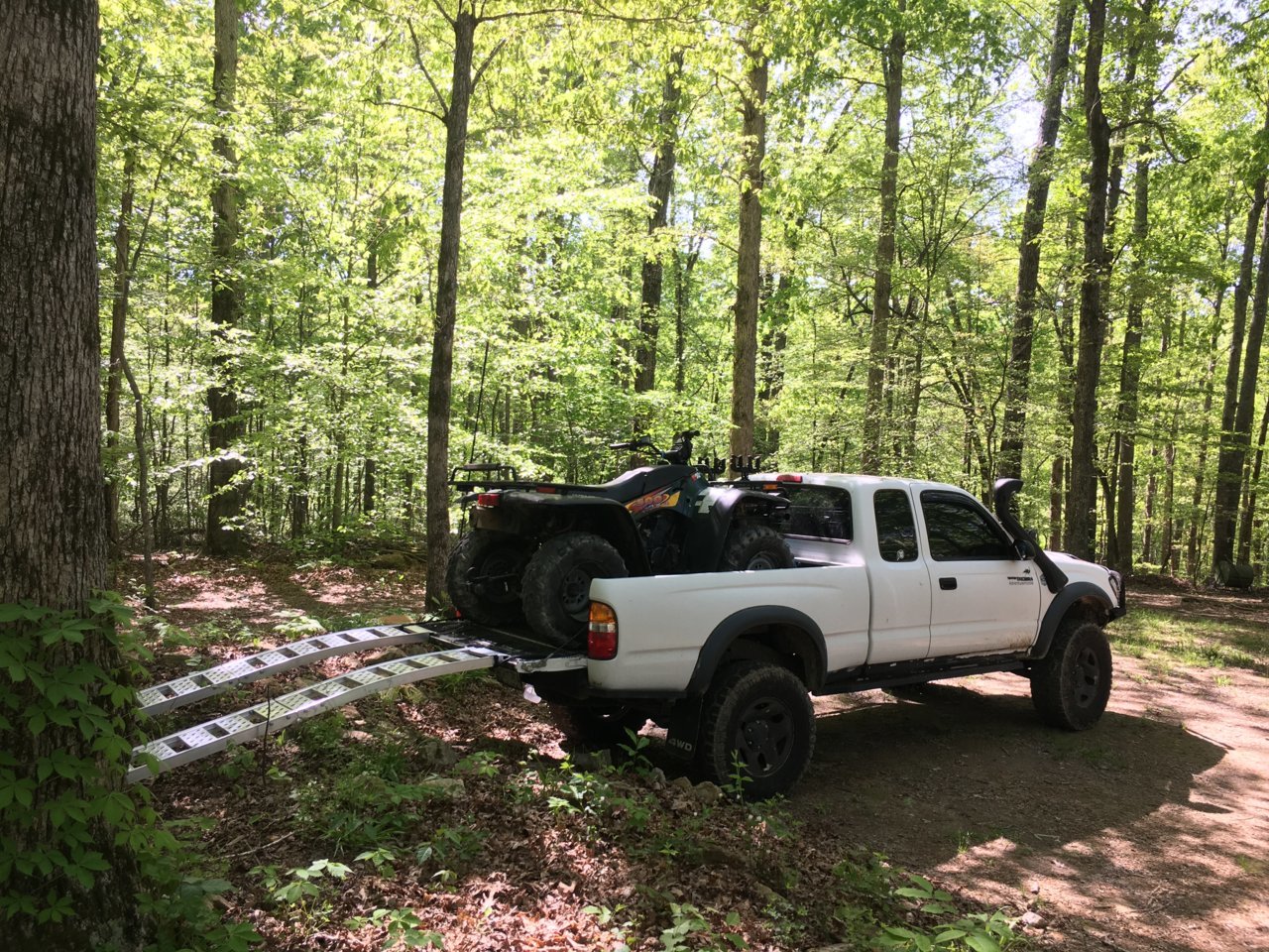

    Yep, here's a pic i found. I know the tailgates aren't meant for sustained overload, so just steady & smooth over it at as small of an angle as possible to reduce force exerted.

    yes. put ramps right on the tailgate.

    Thanks guys, I will do that. 1995 Tacoma has metal tailgate cover and I heard that later models have plastic over there. I can also add a piece of strand board to spread the load from tractor wheels. I can also use a slope on my driveway to lower the angle of ramps, I have such spot I can utilize.
    Removing a tailgate is a PITA in 1st gen Tacoma (which is good thing, so nobody steal it), and I like my tailgate on. If I drive my truck without a tailgate, I feel like half naked :).
