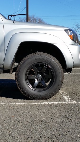

    Yep, ruled out being installed incorrectly... Im so annoyed cause im only a half inch lower in the front and I wanna put my cap on but knowing im gonna be bro leaning is stopping me. 20161113_113945.jpg884's and 265/70 /17 hankooks, looks too high

    Everyone gets a different lift height to some extent. This is mostly due to the actual weight the springs are lifting. My access cab is loaded with tools and gear, both in the cab and bed. Add armor to that, and I'm way heavier than many DCLB Tacos. I'm at 23" with 885s and 1/4" spacer on both sides.
    Without any extra weight you get maximum lift. Add to that the fact you drive very little, and you won't see much change in height for awhile. You need to cycle them to break them in faster.
    I'm at the opposite end. I want my Dakars to settle about an inch - which isn't going to happen.

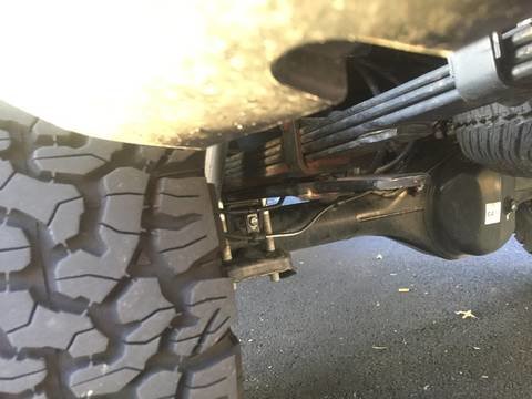

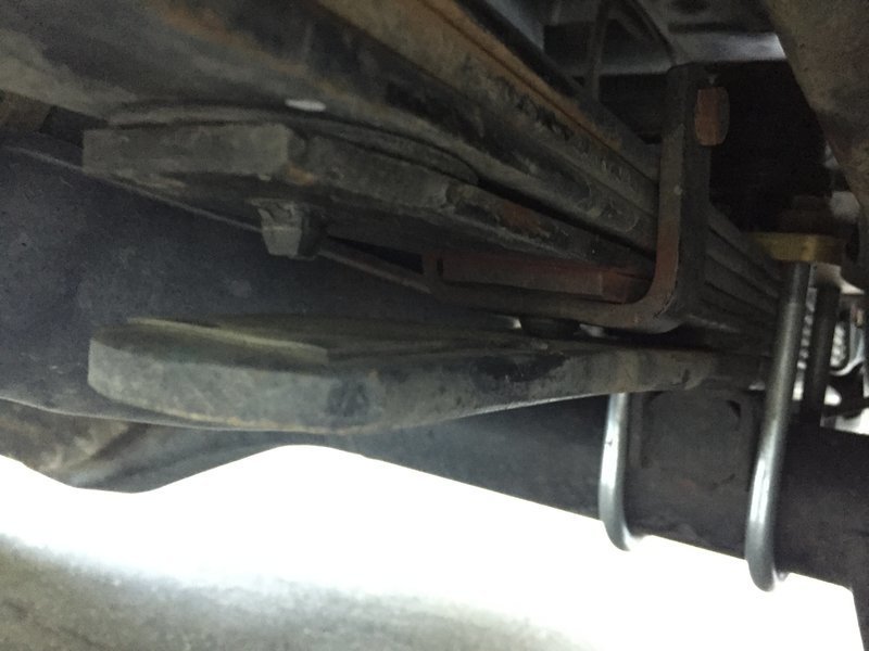

    i have the progressive icon 3 leaf aal and new 3+1 springs from my frame replacement. The new design progressive aal's dont allow for the overload to be used. The overload hits the pins and the brackets on the newly designed progressive add a leafs for some reason.
    Not my truck but here's examples
