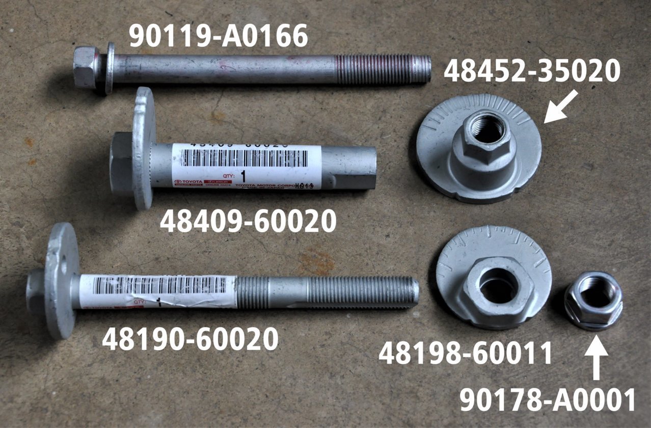

    Here's a good pic I found on here showing the OEM LCA bolts:
    Top of the pic is the front bolt, bottom of pic is the rear. It helped me to see how they went together. I'm sure you know to mark their positions with a paint pen or equivalent before wrenching on them.
    Just some random thoughts, I have heard some folks say you can get a clunk if your Control arm bushings have separated, those ever been replaced?
    I know the sleeve (48409-60020) is prone to seizing in the bushing, dealing with that now on mine. There are aftermarket bolts/sleeves out there that have larger tolerances between sleeve/bushing and sleeve/bolt that can lead to clunking. Tire shops sometimes use these instead of OEM to save cost.
    Of course, if the clunking has been happening since the new springs, I'm probably barking up the wrong tree.

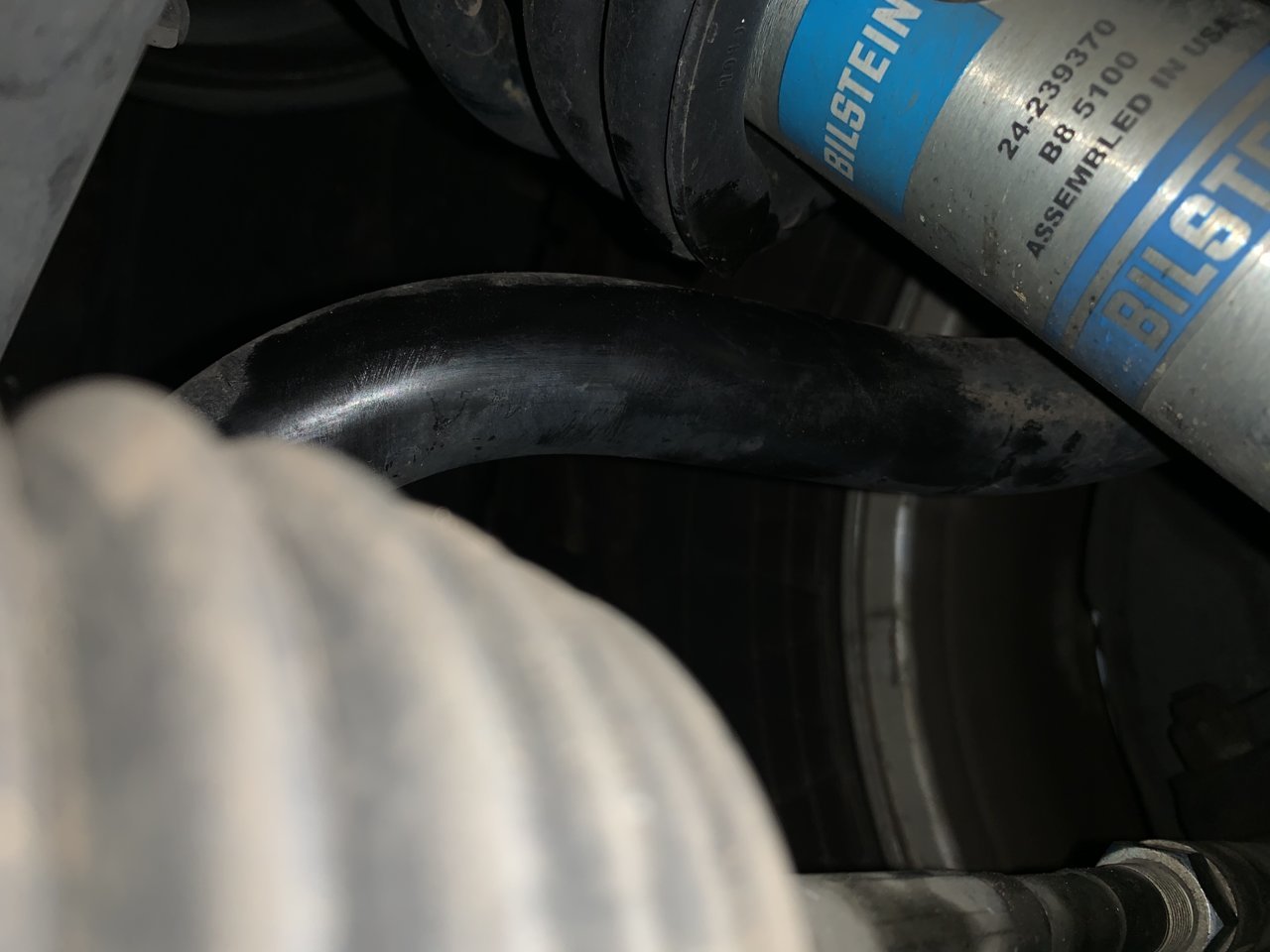

    I’m also going to check my sway bar again....I believe it’s mighty close to the bottom of the coil from what I saw yesterday

    Here’s a pic I took of the sway bar and coil. Not the best pic but would anyone be concerned with the closeness? 8F2818A2-B357-4113-A266-7A9CB6B66380.jpg

    Is the clunk when the front or rear axle goes over the bump? I have had sway bar clunking noises with lifted and stock FJ's and Tacomas, especially with the sway bar causing noise when contacting both stockWith and aftermarket skids. For my FJ, it went away when I permanently removed the sway bar, but overall I learned to live with it with every other vehicle.
