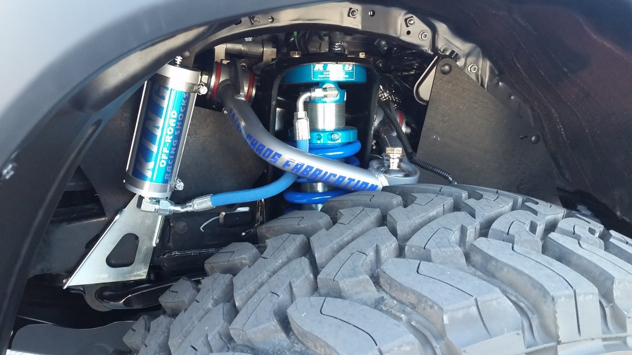

    I would wait. I have the King 2.5's and my shop would not do an install without a UCA swap due to not being able to perform a proper alignment. You can get away with stock lowers but the uppers allow a for correct alignment not to mention full and proper articulation. 20180925_124048.jpg
