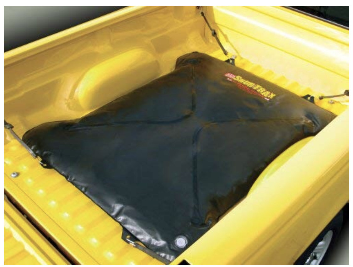

    Last winter I use a bladder bag filled with about 35 gallons of water. Thats about 300 lbs. it’s baffled so water doesn’t slosh around too badly. It will allow about 200lbs of material loaded on top of it just need to be mindful not to puncture it with sharps and that its tied down in some way, i used bungee cords.
    Worked well for me last year, since then I’ve added a Decked storage sys that added about 185lbs, so we’ll see how that works out.

    Water ~ bed
    Clever
