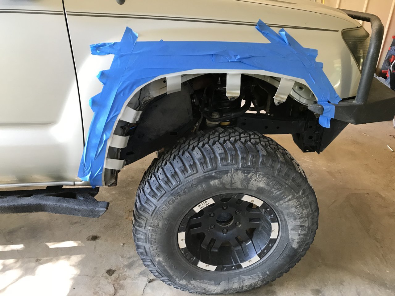

    OP when you think your ready to go to 35's Prepare yourself for this first on all 4 fenders
