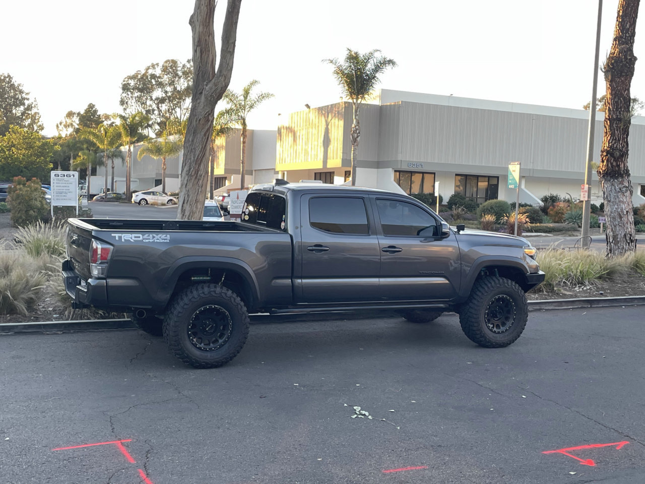

    Recently got 315/70/17s (34.5") and with a good cab mount chop, SPC arms and an alignment shop, I've got no rubbing around town.
    I went with an aggressive tire (KM3s) but I don't do long distance city commutes and I love to get off road. I will say that I did a 3 hour highway drive to some sand dunes last weekend and I don't enjoy highway as much as I did on my 275/70/17 KO2s , but it's not horrible.
    I'm re-geared to 5.29s and tuned for the tire size and gearing.
    There are still some things I still need to do in order to off road and actually use suspension travel. I'm still working out the full approach that I'll be taking.

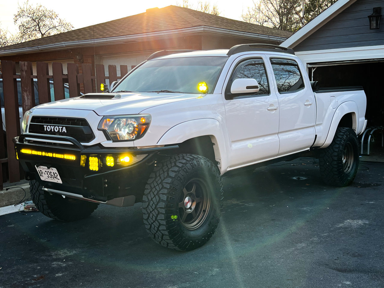

    I swear our long beds make 35’s look like 33’s or Im just used to it now lol!

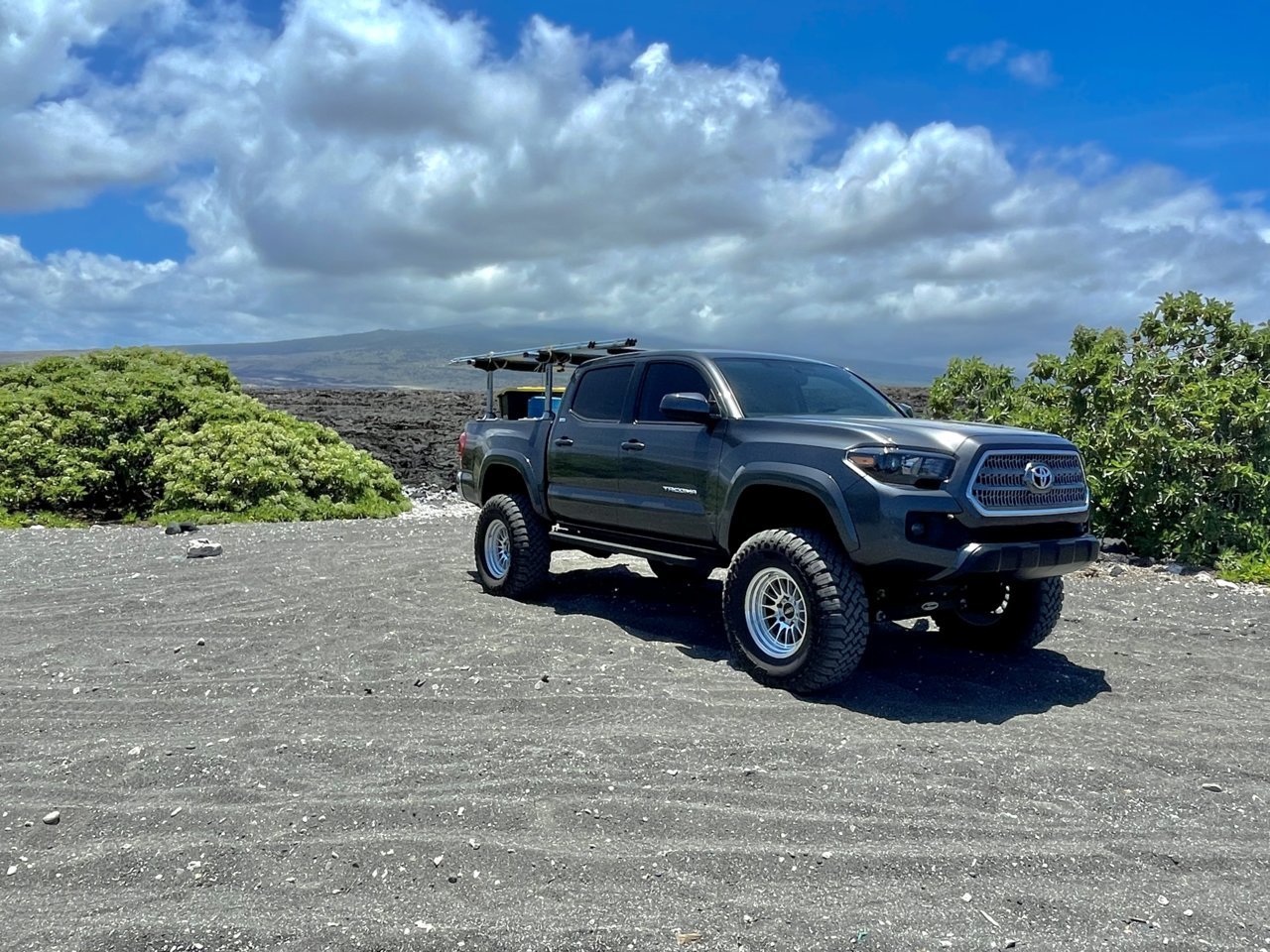

    I was originally 33s, 4.88s and on OV.
    Next step was 35s and making the wheel well adjustments as needed (CMC, pinch weld). I ran that setup for 2 years before switching to OTT.
    Although the truck looks and feels freaking awesome, I’m starting to worry about what 35s will do over time to my steering rack and other steering/suspension components. I know I’m straining it more than rocking 33s.
    But, it ain’t my DD - so no regrets
    I regret lifting my truck so high more than anything
