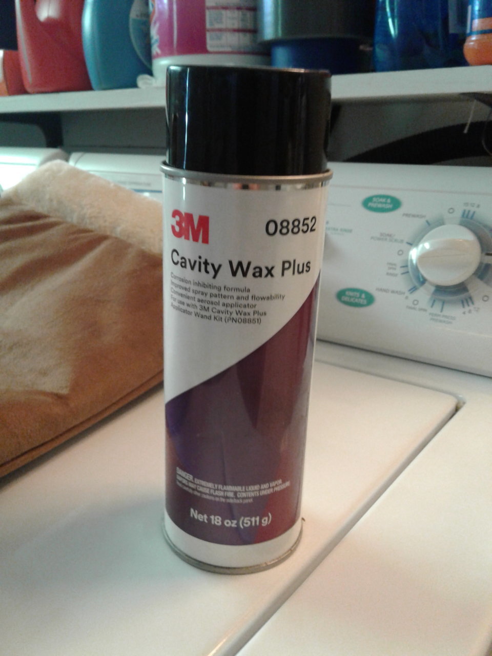

    15314960555532131873481.jpg I really like this stuff so far, it does not make the truck smell like a chemical factory and dries enough to not get all over you if you work on it, holds up really well too.

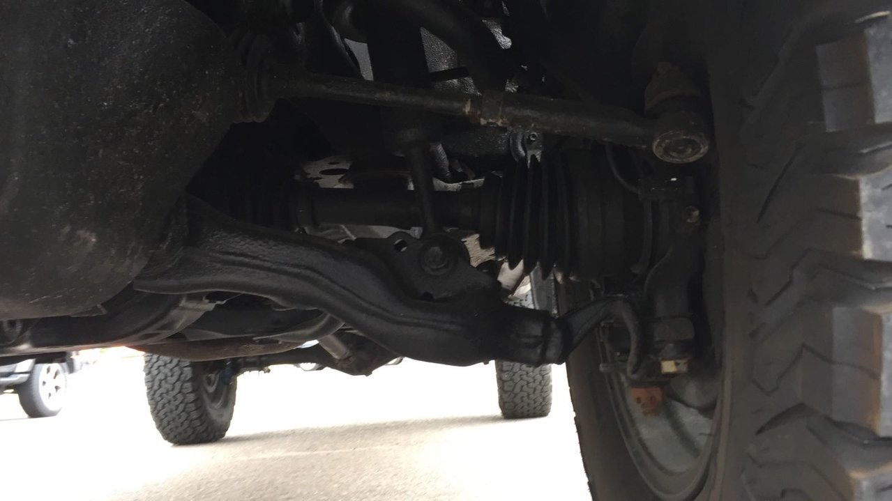

    The LineX was $500. Although it was free because the guy who owns it felt bad for me after I got fucked by a similar "permanent" spray I got from a company the dealership uses. I can tell you that story of you really want to here it. Lol. Kinda long.
    Here's a pic I took to see my CV angle but it kinda shows what the spray looks like. IMG-20180623-WA0002.jpg
