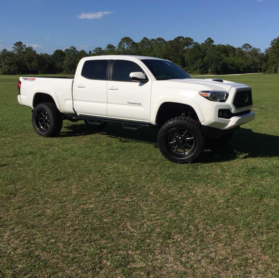

    6" lift on my DCLB since new in 2018, no issues whatsoever.... rear end does seem slightly lower now than when I bought it but I tow a fair amount and probably time for an upgrade.

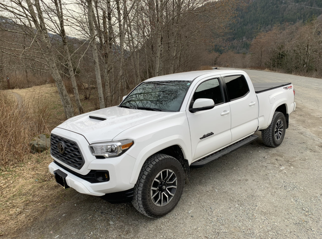

    No not at all. Totally happy with my 9.4” of stock ground clearance. I did go one tire size up tho. However it’s all subjective. To each their own.

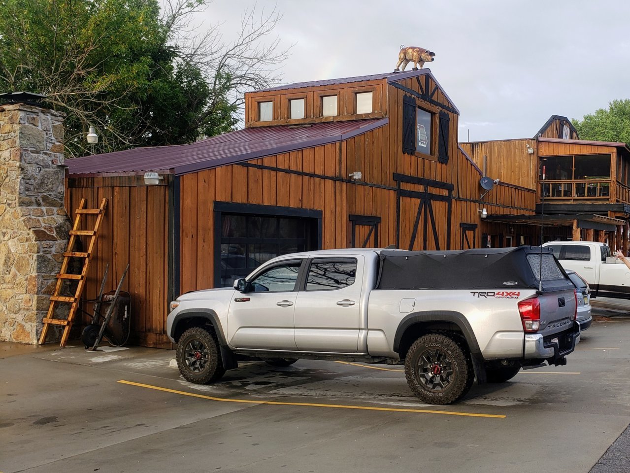

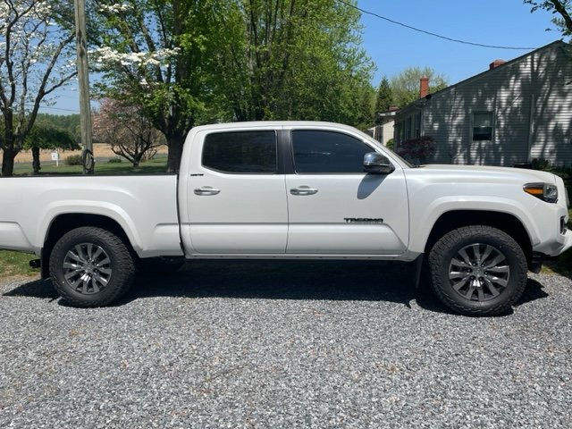

    So I put on a set of FALKEN WILDPEAKS in 265/65/18 looks somewhat better. Might still need a lift.

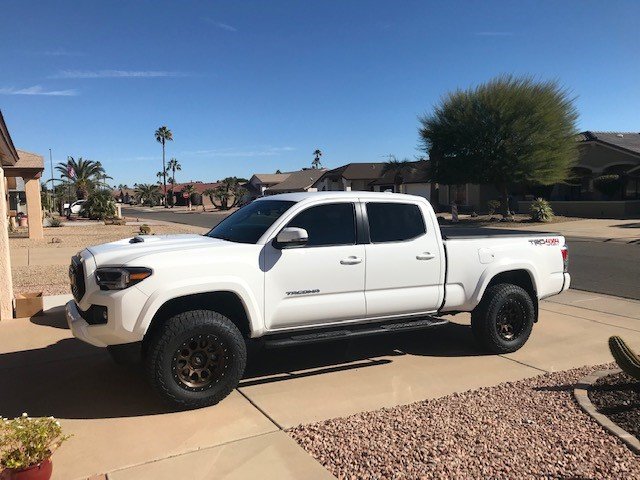

    Lift2.jpg You'll like the Wildpeaks. That's what I have on mine. I put a 2" spacer lift in front and 1" block in the rear. Whenever I need shocks, I'll go with the 5100s I had them on my Tundra and they were great!

    I have not had any issues, yet anyway. It's a pretty mild lift though. I did not do a diff drop either, although I have the stuff to do it, I've read things that would indicate that you don't really need it until you go beyond 2". I'm pretty happy with the lift. I only paid $130 for it and it included the spacers, bolts, spacer blocks for the rear and new U bolts/ nuts, also the diff drop kit. I know a lot of guys don't like the spacers, and honestly, if I planned on doing any major wheeling, I would have done something else. Didn't want to spend the $ yet on the 5100s until the stock shocks have gone for a while. Although I'm not knocking the 5100s by any means. They are great shocks.
    As far as the radar cruise, I had some issues with that whenever I put the Pro grille in, but I solved that by shaving some of the plastic down on the rear of the garnish. Haven't had any problems with that since
