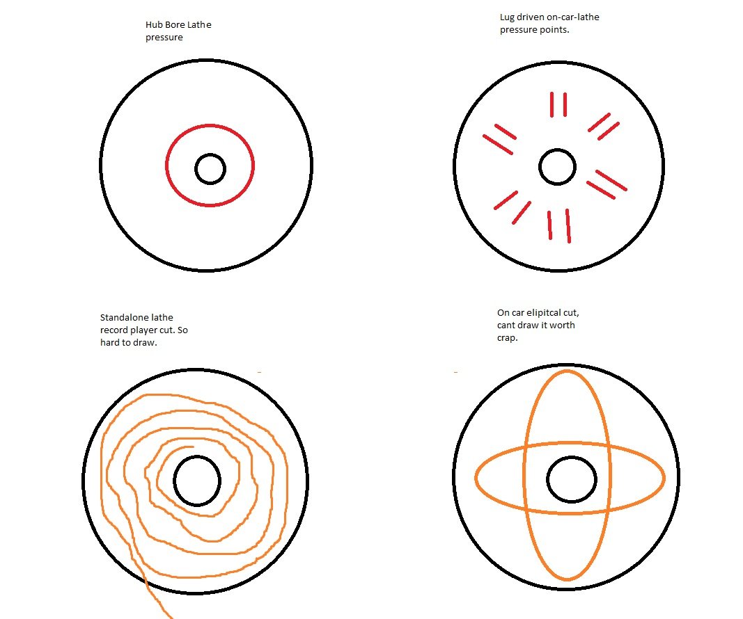

    My points, its hard to explain the machine until you see it in action.
    First, the surface of the hub to the rotor is left alone, so its going to stay the way it's meant to be.
    Second its mounted by the lugs, not the center of the rotor bore. Simulating the wheel and the pressure the lugs cause.
    Third of all it has a runout calibration, standard lathes do not. And I know that 99% of techs do a run out check by eye, not with a dial gauge on the stand-alone.
    Fourth, it has an oblong cut, meaning it doesn't spiral the same speed and shape, it pulses and prevents the "record player" effect that is undesireable.
    I hate setting them up, but they speak for themselves with the cut. I can get a better cut the first try on any vehicle with them, and never worry about accidental runout.
    ENJOY MY PICTURE!

    That's an awesome illustration.
