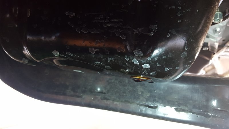

    Mine looks like its stamped onto the oil drain hole...

    I use 90430-12031, which is aluminum core with a layer of blue (usually, sometimes black) fiber on either side. It's designed to deform slightly and is one time use. I get them by the handful from my parts guy. I change it every time I remove the drain plug and have for well over 300K of combined miles on my trucks. I do 20 ft-lbs torque, the book says 25 I think. Shrug.

    There's something about the paint or washer that makes them stick like crazy to the oil pan. I have to give them a little pry to pop them off. But whatever's going on is why they don't leak I guess. :)

    That f*cked me up so bad the first time I changed the oil (it was my first oil change ever and I was completely alone). Sat there twenty minutes trying to pry it off when I looked at the drain bolt and saw a washer......:facepalm:

    Hmm. So your saying thats supposed to be there? :confused:I looked at my drain bolt and there was no washer. Just that washer stuck on the drain pan

    That's not a washer, that's the bung that they pressed into the oil pan to support the threads for the drain plug.

    Not sure about anyone else's but on my oilpan that's a washer getting stuck 4/5 oil changes. My oilpan is smooth around the drain hole. lol sounds so dirty, but it is what it is.
