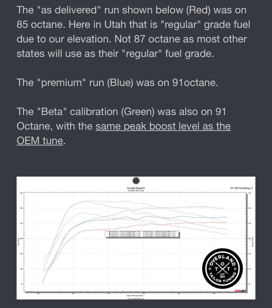

    Premium ethanol free..
    OTT dyno, you basically get rated crank HP/TQ to the wheels with premium.

    Funny how that works. You’re not getting the advertise horsepower if you run regular because the computer is gimping the engine.

    You’re getting rated HP/TQ with regular. 278/317 is rated crank numbers or 254/285 to the WHEELS with regular. You’re getting considerably more with premium 273/323 to the WHEELS!
