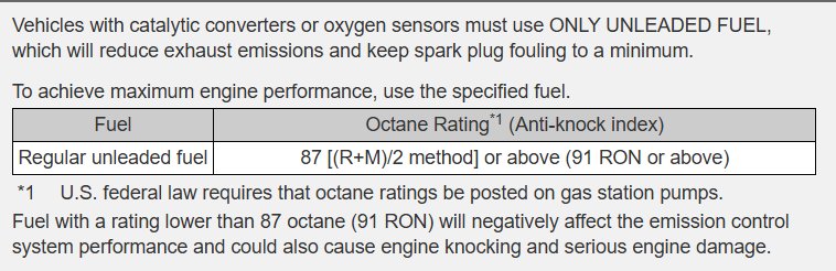

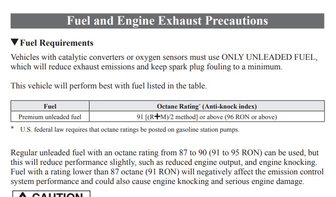

    The following excerpts are NOT from a tacoma manual:
    If your car really needs premium, this is the verbage you would see.
    If it's recommended that your car gets premium, this is the verbage you'd see:
    The second car here is a turbo that only gets its advertised HP numbers on premium gas. It however is smart enough to adjust timing to the premature-detonator grade. Hence, all the literature will recommend premium, but the owner's manual will still say 87 is fine.
    The first car is not turbo'd and will absolutely knock if you put the cheap tank in it.
    If it is starving on octane, you'll both feel and hear it. If you've never heard it knock, you are probably spending too much at the pump.

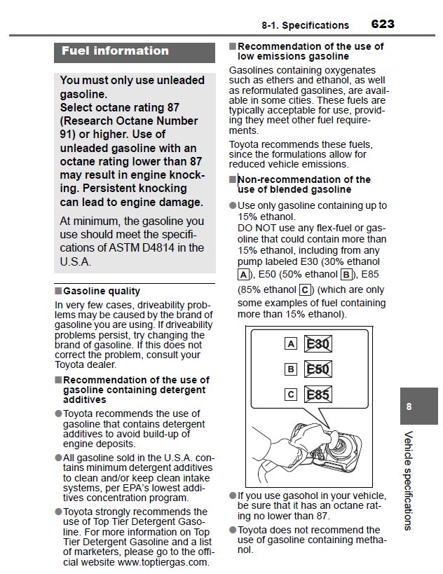

    Note that Toyota explicitly states that E85 should not be used in the '24

    They say E15 is okay by saying "use only gasoline containing up to 15% ethanol."
    Usually the E15 is not labeled as such, but it's sold as the Unleaded 88, so that's how you can tell the difference. It's usually a bit cheaper than regular 87, but some people don't think the risk is worth the savings (especially on older cars). I believe new cars are designed to run it, and late model cars (2009 on, maybe?) can run it.

    Not that its super official but the gas cap on the TRD Pro says not to exceed E15. Im a fan of E15, I have been using it exclusively on the Tacomas I have and have had zero issues so far. Not that its a recommendation, just my own way of doing things. At my local gas station (Sheetz) the "Blue Handle " as I would call it (unleaded 88) is selling at $3.29 where as regular 87 is selling at $3.49 per gallon. That is todays pricing. My thinking is that it meets the octane requirement, burns clean and possibly hotter. So for a cheaper price im actually putting in an arguably, better fuel. Especially if the engineers considered this and designed an engine with seals and such than can handle the ethanol. But as another poster said, the engine might very well be able to respond to the higher end fuels. I might have to experiment a little.
