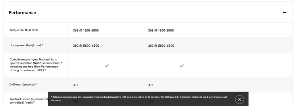

    People often equate High Octane with High Power - They are different.
    Octane is a measure of Fuel's resistance to burning, or pre-ignition.
    Since high octane was used in high compression engines (where you needed to control pre-ignition clatter) people equate power to high octane.
    But even Ford and Toyota provide HP/TQ numbers based on Octane Level.
    Supra HP - Notice the grey box at the bottom.
    * Ratings achieved using the required premium unleaded gasoline with an octane rating of 93 or higher for GR Supra 3.0.
    If premium fuel not used, performance will decrease.
