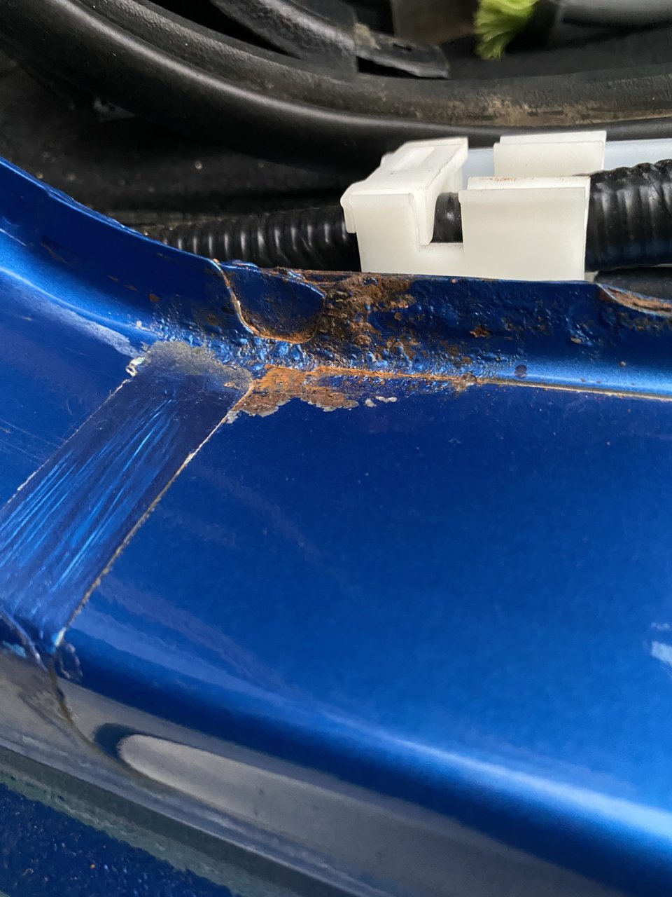

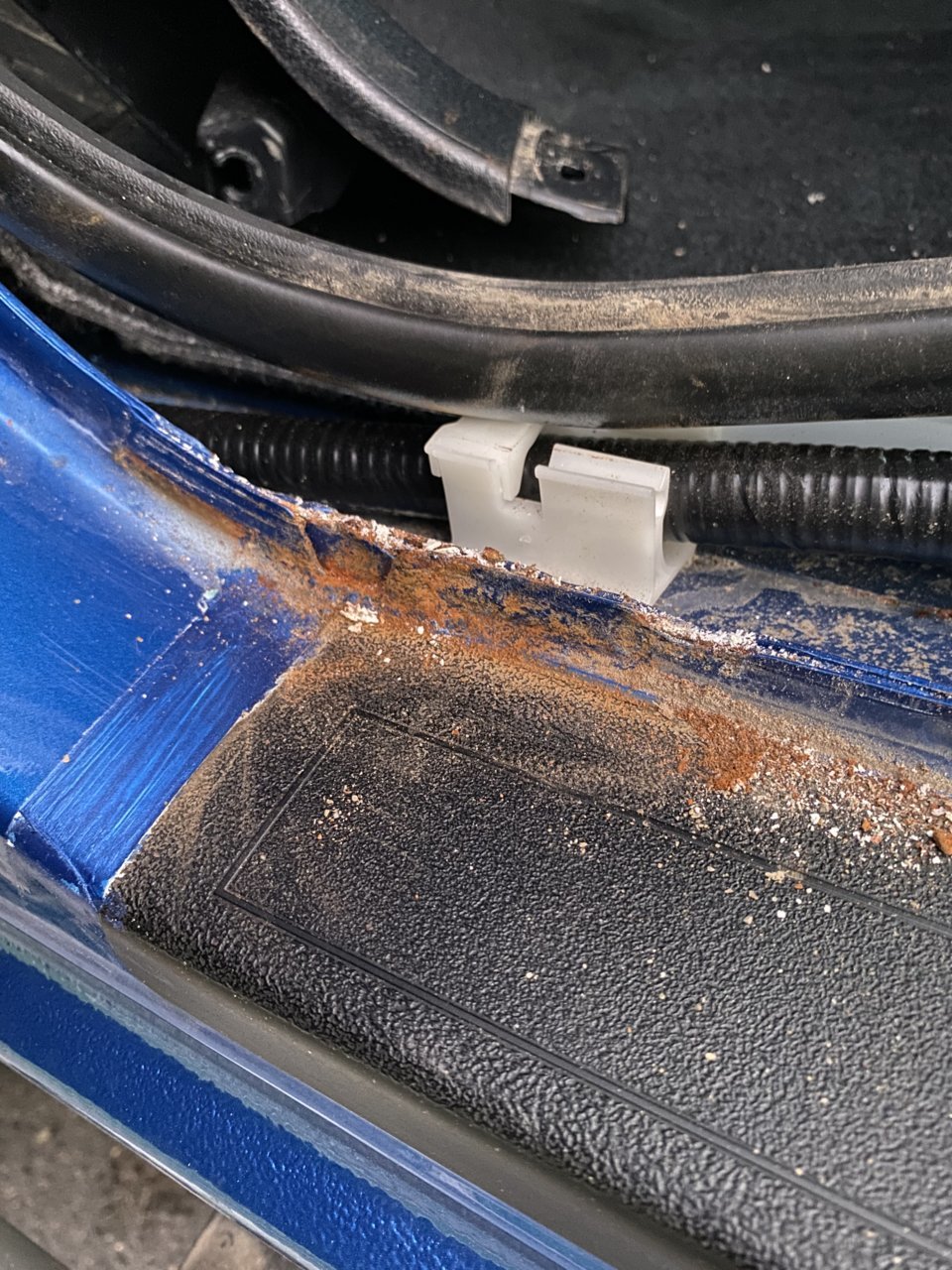

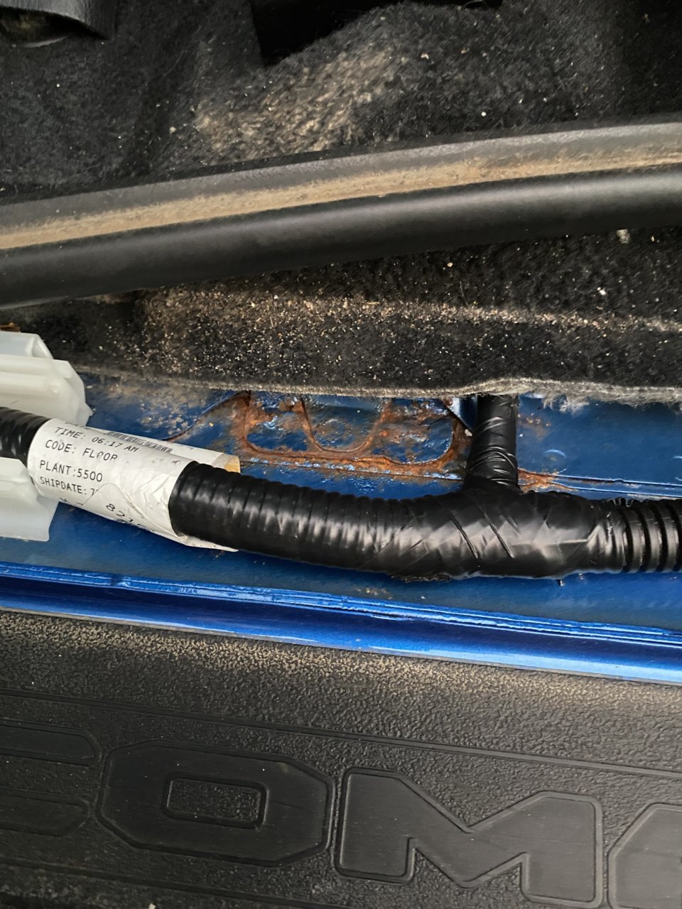

    Had some rust repairs and decided to pop off my door sill covers . Lots more rust then I thought. I’m pretty damn picky about my truck and I’m glad I caught this early. Just trying to figure out best way of dealing with that rust in wire channel . Rust converter and bed liner in channel is my idea atm. I’m not going to be able to sand it all out but if a converter can neutralize and Bedliner to protect . Oil spray a little in fall . Ideas?

    There was a TSB for that.
    See link below from TSB thread.
    It has tips to prevent it from happening again, but you have to get rid of the rust. I'd use rust converting primer myself, then a can of color match paint.

    . Thanks a lot for that. I’ve taken the affected areas down to bare metal and using a rust converter to nip any rust before I prime. Then prime ,paint and clear coat.

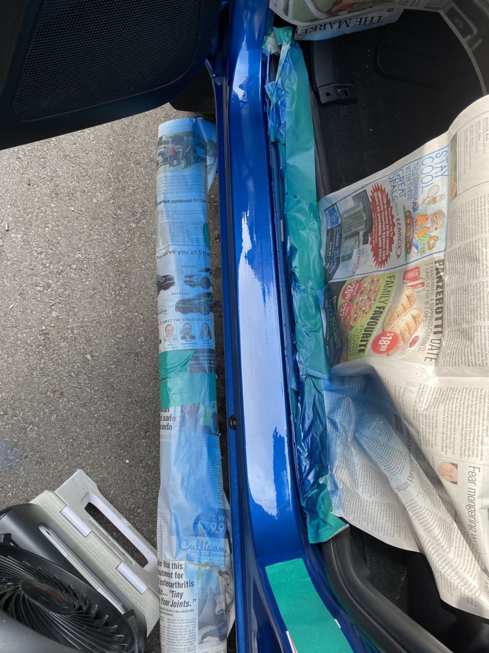

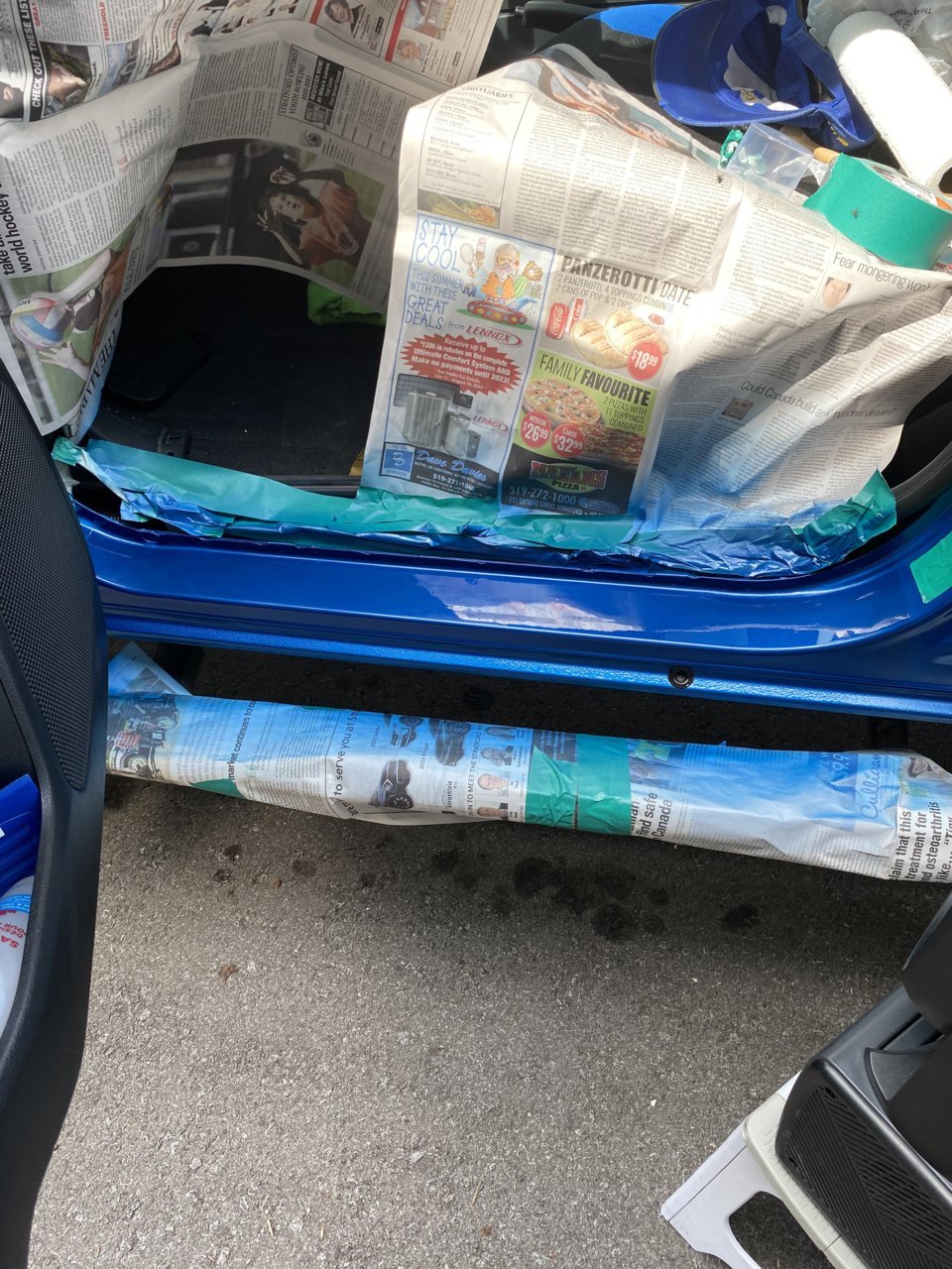

    It’s not perfect but it’s not bad for a rattle can rust repair and repaint. Still 1 or 2 more coats of clear to go on but looks good so far. Got a new sill guard I’ll put on later in the week.

    The plastic door sill cover just pops off when you pull up on it and then the gasket comes off very easy as well and gasket reinstall easily over the pinch weld. I mainly use my Drivers door being a single person and no family. But the drivers side was the only one that had any rust in the channel on mine and the others were clean.

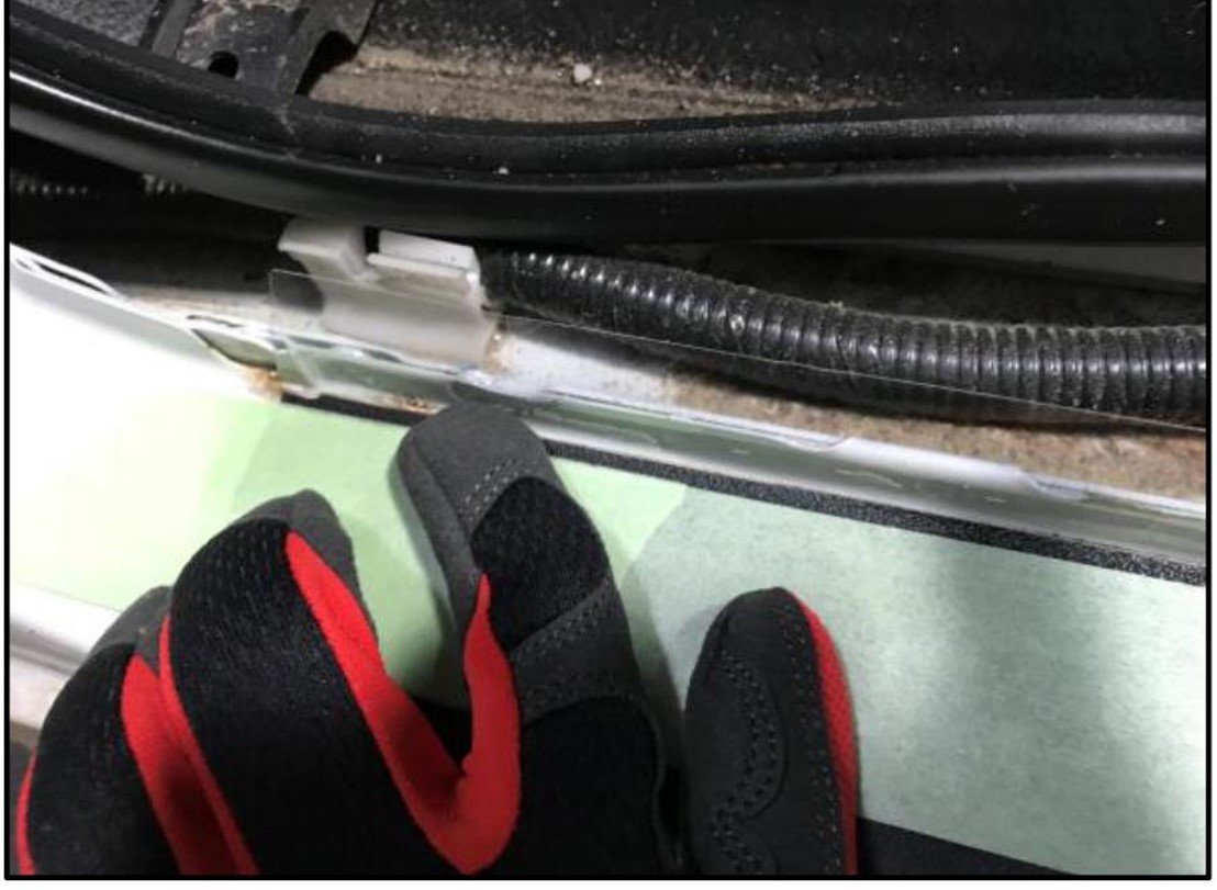

    On Page 4 and 5 Of the linked document they talk about "flange Tape" and show clear tape being applied to the Pinch weld. But i cannot find anything like they describe as Flange Tape literally anywhere.
    Anyone got any ideas?

    I can't say for certain, but I would assume it's 3M Scotchguard paint protection film.
