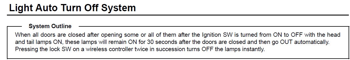

    So, today I had my headlights stay on with no keys in the ignition.
    Here is what happened, I opened the passenger door and put the keys in the ignition and turned
    the key to "run" with out starting the engine. I cracked the windows and then removed the keys from
    the igniton. My headlights remained on. HERE IS WHY.
    1. Get in the truck from the drivers and start the truck.
    2. Turn the headlights on and then stop the engine. LEAVE THE HEADLIGHTS ON.
    3. At this point the headlights will still be ON. Open the door and they will go OFF. THIS IS NORMAL
    4. Now exit the truck and walk to the passenger side and open the door. KEEP THE DOOR OPEN.
    5. Insert the keys in the ignition, then turn the key to the run position. No need to star the engine.
    6. THE HEADLIGHTS WILL COME ON.
    7. Remove the keys from the ignition. THE HEADLIGHTS STAY ON.
    You can shut the door and lock them. But the headlight stay on.
    I don't like this. This would drain the battery.
    Please let me know if your truck does this.
    I have a 2007 and I also tried it on a 2010.
    Yes, I know the simple answer is to just use the drivers door.
    But I was at the motocross track and it was a tight squeeze on the drivers side.

    You could turn the headlights off with the switch too...:confused:
    What you described is normal for 2nd gen Tacomas.

    Definitely an oversight by the engineers.. I think he is just putting it out there for people that may not know. Might save someone from a dead battery. Thanks OP.

    Yes, Just letting people know.
    Some people might just leave there headlights on all the time and rely on the
    truck to turn them off. And It does. But if you are in this habbit, just remember
    to use the drivers side when messing with the ignition. Or at a minimum go around and open ND then close the drivers door. Lol

    Results/findings: Open the driver's door test: headlights go out. Passenger side open door, turn key to ON: lights come on. remove key from ignition: lights stay on. Close the door/lock: lights stay on. Bang the top of the dash (like when you're trying to stop one of those damn rattles behind there.... :rolleyes: lights stay on. ;)
    Open the driver's door: lights go off.

    I was installing new fog lights and I used the passenger door to get in to turn on the lights to test the connections/aim them. Assumed they would turn off after like normal and went inside, 10 minutes later I go out and the lights were still running.

    It's interesting because my truck has some kind of monitoring system that will turn off the dome lights after a set time. I'm not sure if there is anything else on the that it can control and shut down. I also really like that the windows stay powered for a while after shut down and was pleasantly surprised when I discovered the feature by accident several month after I got the truck.

    I inadvertently found this out today. Was rainy during daylight hours. Had the lights on and forgot to turn them off. Unloaded a bunch of stuff from the passenger side, forgot I needed the mileage for business records so I turned the key to check it then went inside. Hours later, I realized my lights were on... and the truck was dead.
