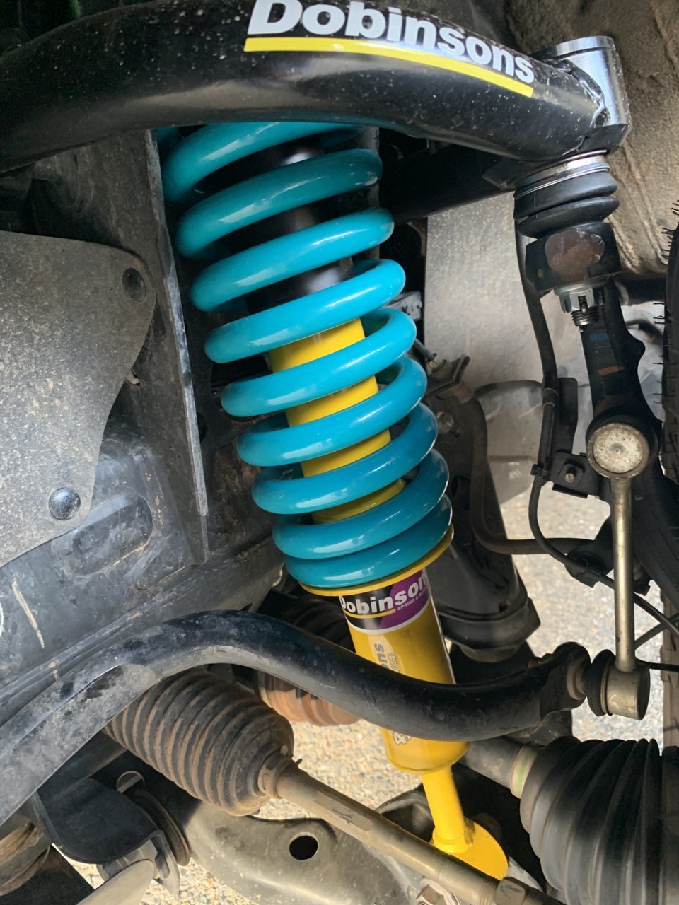

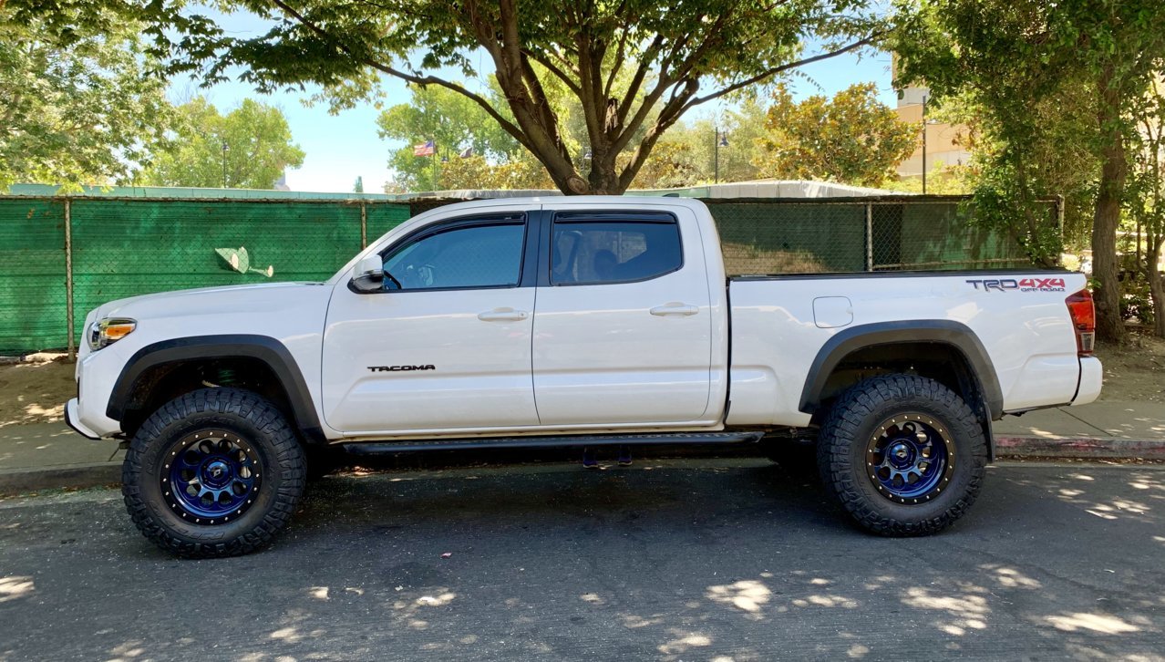

    Loving my Dobinson’s suspension. Was planning to shell out for Kings but the shop recommended these as a daily driver alternative. I’m happy I listened. I’m not bombing down wash boards at 50 but I can do it comfortably at 25-30 now. Can’t speak to the billies but the past 3k miles have been quite enjoyable. I should have gotten black coils but I do love the original teal.

    2019 Cement TRD OffRoad
    Man thats a great looking truck, I have the same Color and I like the tiny teal peaking through. Looks "Aftermarket" ya know? Can you comment on the feel of the ride on and off road compared to the stock suspension? And did you go 2 inch or 3 inch lift?

    With the new tires it doesn’t peak as much lol. I went with a 3inch front 2 in the rear. Stock suspension I was never happy with off road. It get very jarring when I hit bumps and the truck would shake. With the dobinson’s, I did go with a stiffer front coil so the nose dive during braking is gone. Can handle higher speed turning better. On an unpaved road I usually go to for a quick trail rung I was able to go around 10-15 mph on the stock and can comfortably go 25-30 now. I could probably go a little faster if I wanted to. It is a plus that these do come with built in shock boots to keep the dirt/dust accumulation down on the shock shafts.

    Dang! Sweet what you did to those Ray10s.

    They did it and took my money! I just wrapped them in Nitto Ridge Grapplers 285/75/17
